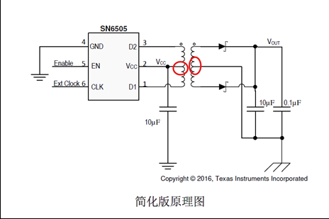

Hi Team,
Do we have similar device but don't have transformer center tap? No bridge. Thanks in advance.
BTW, can this series output 20W power? Or less than 5W?
BRs,
Francis

Hi Francis,
For SN65xx device with push-pull topology center tap transformer is required.
Is there any specific reason customer is looking designs without center tap transformer?
Please check UCC25800 if customer is interested in LLC converter. What is the input voltage and output voltage requirement.
Thanks.
Hi Shinu,
Thanks for you help here, no some reasonable reasons, customer just want this design be easy, so do we have other choice?
BRs,
Francis
