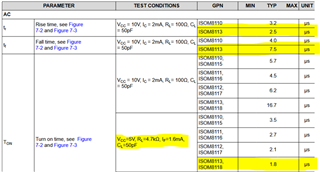

  • My apologies - one further question. I notice that the Ton should encapsulate the Tfall time as denoted in Figure 7-3. However, the Ton time is listed for a 5V 4.7kR If=1.6mA as 1.8uS as below. This is shorter than the listed fall time of 2.5uS? I assume this is again to do with the circuit loading but we need some guidance to understand how to properly determine these timings for our design.
    After a quick discussion with our team members, I realized this is a not as straight forward. We need to pay attention to the test conditions to make sure the output transistor is in saturation mode (being used as a switch).
    • Saturation mode (when ISOM is acting as switch) is achieved when IF * CTR >>IC_max.
      • Saturation mode specs are shown in Ton, Toff, and Ts when the test condition starts with VCC=5V.
      • You will notice two conditions are provided to show the device in saturation mode with a strong IF (16mA) and a weaker IF (1.6mA). The typical application curves usually use the 1.6mA test condition.
    • The ISOM811x is in active mode (analog behavior) when IC_max > IF *CTR.
      • Active mode specs for tr, tf, Ton, Toff can be identified when the test condition starts with VCC=10V.
    Please use the saturation mode specs when calculating the timing parameters.

    Does this mean that the saturation timings are the worst case and non-saturated timings are faster? This is surprising as you'd assume the rise/fall would be sharper with more current on the LED side. Our input current is closer to 1.5mA. In this case, does this mean the worst case of 21uS is very unlikely?
    Many thanks
    Yes, the worst case Ts is unlikely. Keep in mind that Ts (max) is included in the TOFF measurement (figure 7-3), and the provided TOFF is a typical value.
    The data sheet shows saturated mode will have faster switching performance when compared to unsaturated (with the specs where IF = 16mA are even faster). The red boxes are the non-saturated timings. TON + TOFF together here is 19.4us which is slower than the saturated (at 1.6mA) TON + TOFF which is 15.3us. Therefore, the saturated performance is faster.
