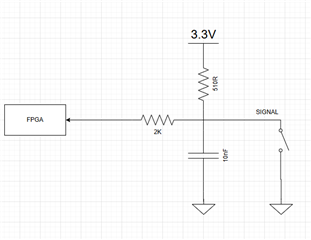

I have an input signal that is connected to ground by default and pulled up during normal operation. During EMI testing, the signal sometimes falsely detects as low (ground) even when it is being pulled up.
To mitigate this issue, I’m considering using a TI ISO121x device due to its robust sensing capability. However, these are isolated input devices, and in my system the return paths are shared — meaning the isolation is essentially broken.
Is it possible to use the ISO121x in a non-isolated configuration, leveraging only its sensing functionality while ignoring the isolation feature?
Alternatively, could you recommend a more EMI-robust input circuit design that doesn't rely on isolation?
