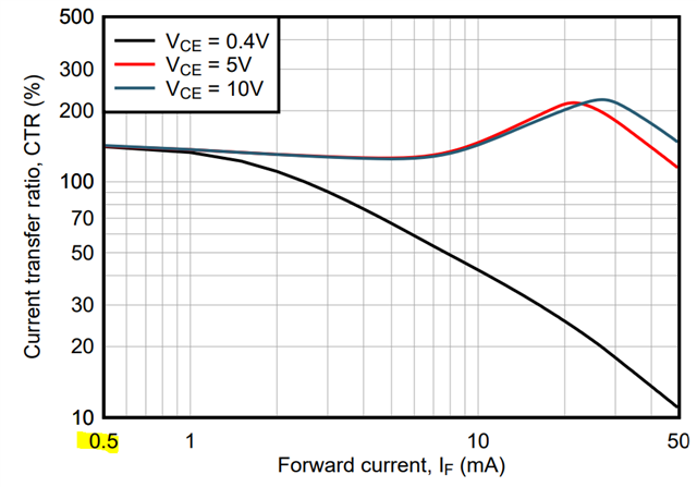

Q2. CTR Characteristics at Low Forward Current
In the datasheet, the CTR (Current Transfer Ratio) vs. Forward Current characteristics are only provided for forward currents above 0.5A.
For some applications, we would like to understand CTR behavior at lower forward current levels (e.g., a few mA up to 500mA).
Do you have any additional specifications, characterization data, or application notes covering this lower current range?
    Since the forward threshold current is 0.5mA (IFT) and Absolute max is 50mA (any value >50mA will cause device damage) - No Data exists for outside this range nor we recommend it's usage beyond this range.

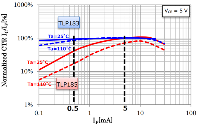

    For example, Toshiba's TLP183 has specifications that match low IF drive. Even if IF=0.1mA, the CTR specifications will not drop. Are there any plans to release a product that matches these specifications for TI's photoemulator?

  • The ISOMxxx's input is not an IR LED but an active circuit. It is probably not possible to design such a circuit that consumes less than 0.5 mA.

  • Hi Conor,
    It is mentioned in datasheet itself - it is 0.5mA
