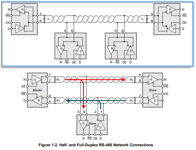

Hello, I'm trying to split one RS-485 signal into eight separate signals via an ISO 3082 transceiver. Could anyone advise on the topology to use? the more i browse thru the following application notes the more confused i am , one app note advocate daisy-chain while another call for repeater.
  Anyone please advise which topology to adopt? thanks and please reply soon.

  • Hi Cosgrove,
    Thank you for reaching out. The answer to this question depends on what you are trying to achieve with your application. The below diagram from RS-485 Basics Series shows the typical RS-485 (half-duplex) bus that is sending to several nodes. This is configuration would be capable of "splitting" or sending the signal to 8-separate nodes since each node will receive the message on the bus. Without the complexity of a daisy chain or repeater.

  • Hi Andrew thanks for the reply, I m configuring RS485 as full-duplex, what would be the connection?

  • I m configuring RS485 as full-duplex, what would be the connection?
    Full duplex would be the configuration shown below the one in the blue box.

  • Hi Andrew, in my design, the RS485 Master is connected to the MCU, the 8 slave RS485 are connected to 8 cameras, and not the slave MCU. If in any event if i m not using PROLIBUS and using ModBus RTU, how can the master send data to camera3, while the rest of 7 cameras not receive?
      If CTS and RTS are not to be used, then what else can i use for the RS485 master to communicate to the slave camera 4 example? please advise soon, thanks.

    As discussed, RS-485 only uses an A/B differential line to communicate between a master and multiple slave nodes. Each node on the bus will see the same signal. The ISO3082 will interface with the bus (receive and transmit messages) to a local microcontroller.
    The slave nodes are commonly programmed with a unique ID (or address) and only transmit on the bus when their address received by the master controller. Only one node can be controlling the bus at a time. Interaction between multiple slave nodes is handled by the master controller using a communication protocol that is programmed into each MCU. The ISO3082 will only interface with the bus on an electrical (physical layer).
    It is up to your application do decide which RS-485 -based communication protocol is used.
