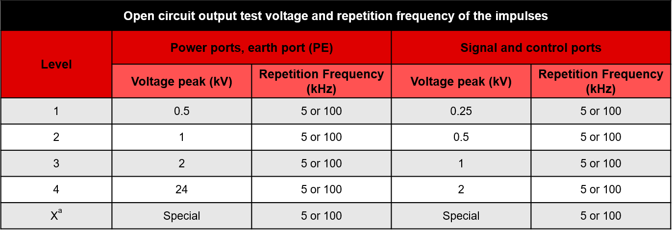

    Test level
    The EFT immunity test is conducted successively at levels 1-4 with the option of adding additional levels above, below, or in between the others. Level 1 represents the lowest required test with a voltage peak of 0.5kV on the DUT power ports while level 4 represents the highest test with a voltage peak of 4kV.

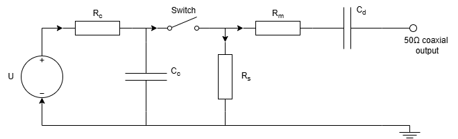

    Simplified Burst Generator
    U – High voltage source                                                        Rs – Impulse duration shaping resistors
     Rc – Charging resistor                                                           Rm – Impedance matching resistor
    Cc – Energy storage capacitor                                               Cd – DC blocking capacitor

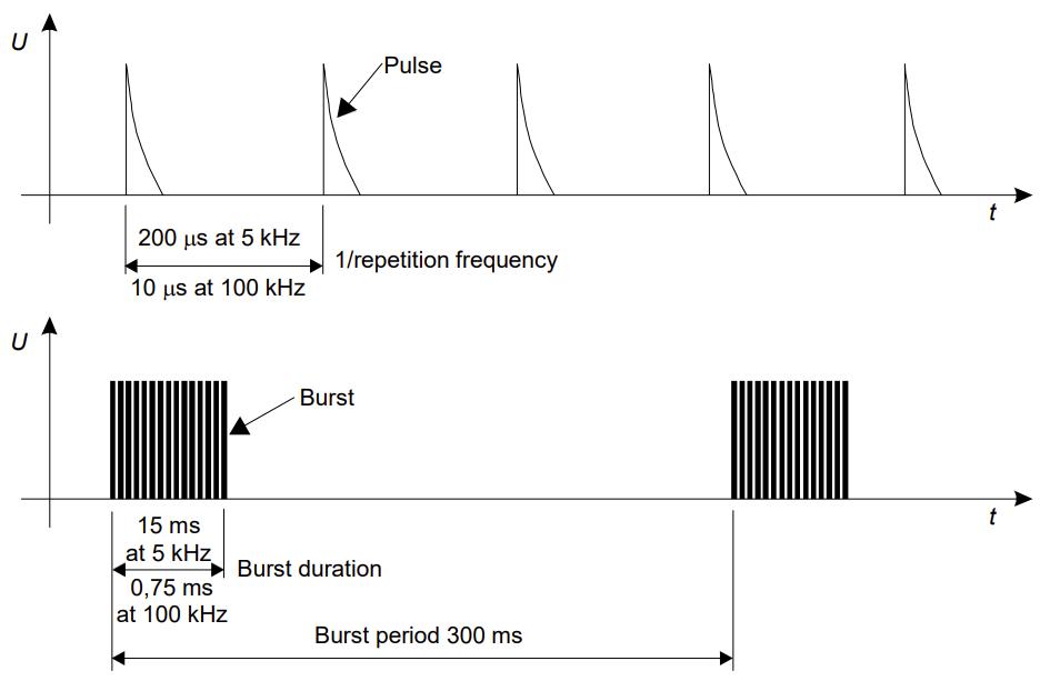

    The EFT generator must give a coaxial output for a duration of 15(±3)ms at 5kHz. The outputted waveform is shown below.
    Generator output of electrical fast transient/burst

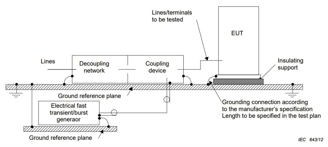

    The following equipment is used in the test setup:
    • Device under test (DUT)
    • Coupling device (network or clamp)
    • Decoupling network (if appropriate)
    • Test generator
    Test setup & procedure
    The EFT generator is applied to the power ports of the DUT via the coupling device as shown in the figure below. The generator, DUT, and coupling/decoupling devices all share the same ground plane.
    Block Diagram of EFT Immunity Test

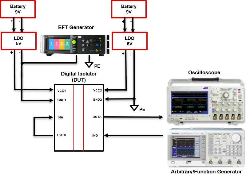

    Starting at level 1, the EFT generator triggers a burst into the power port while the signal generator is passing a signal through a logic pin. The operator monitors the scope to capture any functional loss or device failure. At each level, the device is struck with positive bursts and negative bursts. The time between tested ports should NOT be less than 1 minute. It is considered a pass if the DUT/EUT withstands the burst at a certain level.
    Example schematic of ISOxxxx under test:

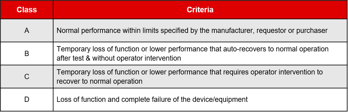

    The test results are evaluated by classifications of function loss or part degradation, and performance level defined under test levels section above. The classification of function loss or part degradation are tabulated below:
    The overall test results are listed as:
    ISOxxxx passes level 4 at criteria A
    or…
    ISOxxxx passes ±4kV at criteria A
    Which means, ISOxxxx withstood ±4kV bursts without any loss of function or degradation of performance.
