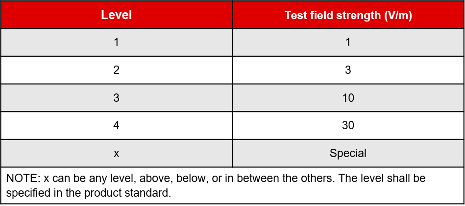

    Test level
    The radiated immunity test is conducted at one of the levels above with the option of adding additional levels above, below, or in between the others. Level 1 represents the lowest test level with a field strength of 1V/m while level 4 represents the highest with a field strength of 30V/m. At a given test level, the test is conducted across a frequency range determined by the manufacturer. At TI, we test at low frequencies (80MHz – 1GHz) and high frequencies (1GHz – 6GHz).

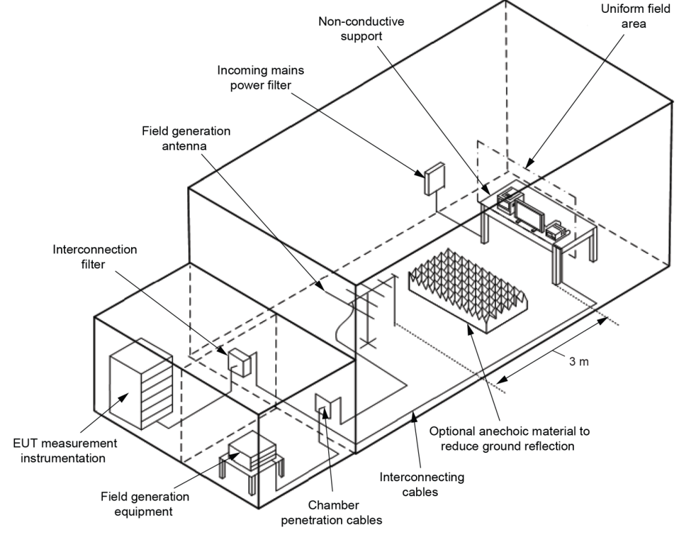

    The following equipment is used in the test setup and procedure:
    • Anechoic chamber
    • EMI filters
    • RF signal generator
    • Power amplifiers (to amplify signal)
    • Field generating antennas (i.e. biconical, horn, log periodic etc.)
    • Isotropic field sensor
    • Power measurement device for forward power
    • Associated equipment to record the power levels

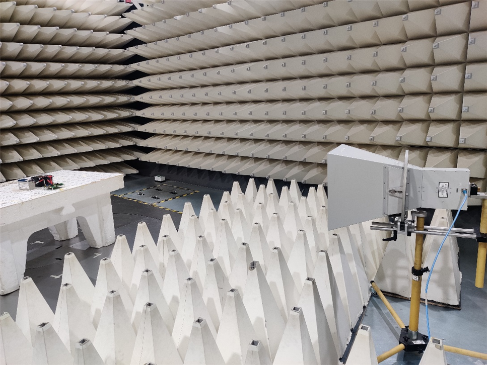

    An example of a semi-anechoic chamber (SAC) is represented in the picture below in the test setup & procedure section. To reduce EMF reflection, this chamber has anechoic material around the entire room (excluding the floors).
    Test setup & procedure
    The DUT is placed on a non-conductive table within the uniform field area at a height of 0.8(±0.05)m. The antenna is set 3m away from the DUT with a piece of anechoic material separating the two. This setup can be seen below.
    Setup for (1GHz – 6GHz) Test with Horn Antenna
    The test is conducted at a test level, frequency range, and test modulation. The frequency range is swept with a type of signal modulation, and the test is only paused to adjust RF signal level, switch oscillators/antennas, or the tested frequency range.

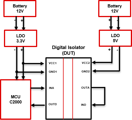

    Example schematic of ISOxxxx under test:

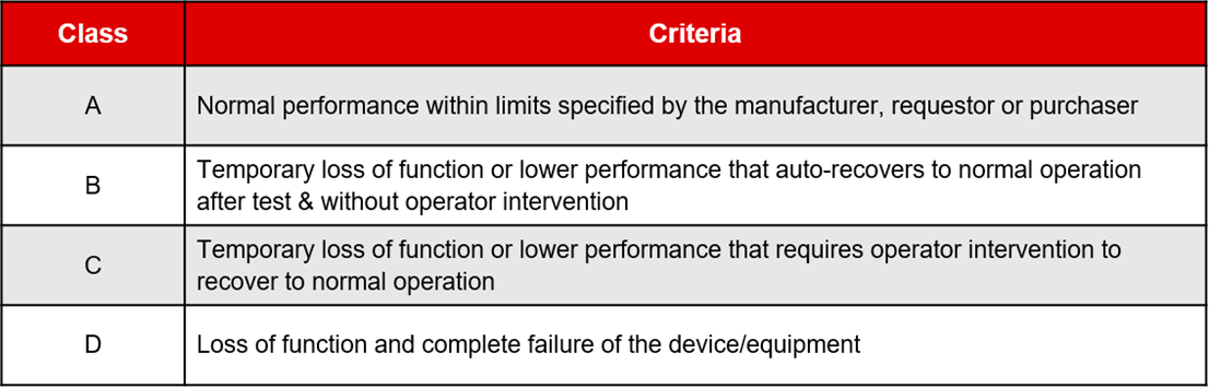

    The test results are evaluated by classifications of function loss or part degradation, and performance level defined under test levels section above. The classification of function loss or part degradation are tabulated below:
    The overall test results are listed as:
    ISOxxxx passes level 4 for (1GHz – 6GHz) at criteria A
    or…
    ISOxxxx passes 30V/m for (1GHz – 6GHz) at criteria A
    Which means, ISOxxxx withstood a test field of 30V/m for frequencies between (1GHz – 6GHz) without any loss of function or degradation of performance.
