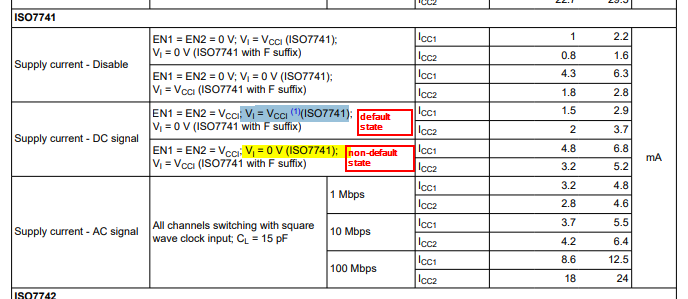

ISO7741: Datasheet clarification on supply currents
Part Number: ISO7741
P14 / Table 5.10 lists supply currents for different configurations.
The ISO7742F has two inputs, two outputs per side. Just looking at a single side for now.
I understand if both inputs are tied to supply (VI = VCCI) that the total supply current is 6mA max (for DC) over temp/process.
For DC, if the outputs are left open, what is the added leakage current? Or are we still under 6mA max?
