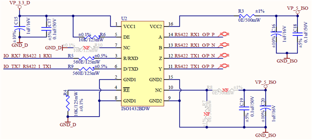

    • Can you please share the schematic?

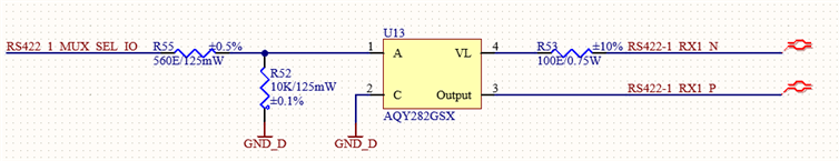

  • The schmatic looks okay to start, however, I do not see any termination used on the differential lines. I will await your replies to my previous questions for further review.

    Transceiver:
    Surge protection:
    Termination selection circuit

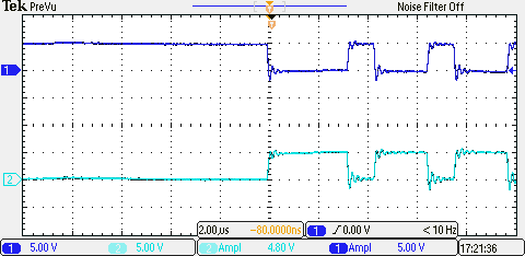

    Waveforms:
    1. R
    CH1 : Blue : RX_P,
    CH2 : Sky Blue : RX_N
    2. Termination ON at baud rate 921600, not working

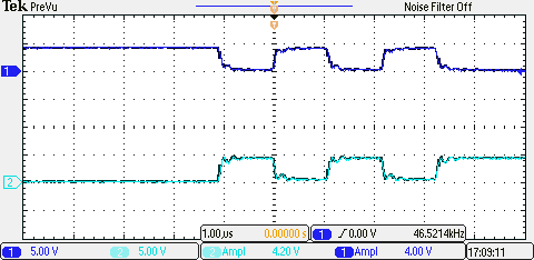

    3. Termination OFF, working at 921600
    4. Termination OFF and externally 120 ohm resistor connected on RX_P and RX_N lines, working at 921600

    Thank you for the added details. The above waveforms show valid RS-485 waveforms. The minimum differential load resistance between either A/B or X/Y pairs is 54 ohms. An impedance less than 54 ohms can lead to communication errors. Please check the cable impedance and measure the differential load resistance of each differential line.
    Please also try to connect a 100ohm resistor externally like you have done with the 120ohm resistor and see if communication is acceptable. I suspect there is more than one 100ohm termination turned on on each line and that is causing a differential impedance of 50ohms thus effecting communication.
