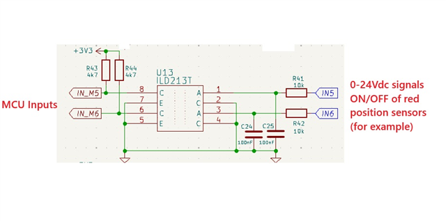

Is posible replace ILD213T by ISOM8111 to work as switching to isolate/protect the input pin of any MCU ?¿
(apart from ILD213T being double)
Thanks in advance !!
  • Hello German,
    ISOM8110 is functionally equivalent ILD213T and should be able to drop into the schematic without major changes. Please note that the ISOM8110 is currently only a single channel device, therefore the footprint may need to be changed.
    Andrew
  • Thanks to confirm that both are equivalents.
    Talking about de Low Pass filter with Resistor+Capacitor, wich values do you recomend in input pins of ISOM8111? Any Application Note about it?
    Thanks in adcance !!
  • Thanks so much Andrew, any Application note with typical connections (or recommended values) to work as switching & input filter (RC, ...)? (no need inputs with high speed)
    Thanks in adcance
  • Hello German,
    The filter's cut off value needed for your design will depend on your application requirements. The current filter's cutoff frequency is ~160Hz = 1/(2*pi*10k*100n). This filter selection is okay. The same filter will work for ISOM8110 since it is a functional match for the current design. Please note that faster data rates may be possible since ISOM8110 has a faster isolation technology (BW = 680kHz).

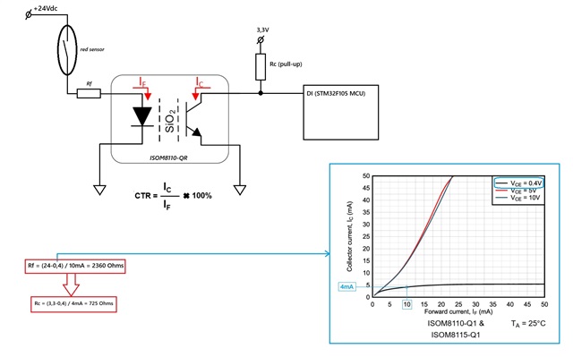

  • Sorry, but is a little confuse for me understand the swithing mode of ISOM8110/1. I find it difficult to understand the relationship between a sufficiently high IF, so that the output transistor works saturated (small VCE), for specific conditions of a 'pull-up' resistor connected to 3V3 (input of my MCU). Could you help me ¿?
    Is this hypothesis presented in the image correct?
    Thank you for your patience.
  • Hi German,
    The ISOM811x will be in saturation mode whenever the collector current is limited below the IF*CTR, or IF*CTR > IC. This is shown in the figure where VCE = 0.4V.
    The equations you showed are mostly correct.
    • RF = (VCC - VF) / IF = (24V-1.4V)/10mA = 2260ohms
    • Rc is correct. However, please note that 4mA limit is set by the pull up resistor. (VCC=5V, RL=4.7kΩ; which corresponds to the Ic=1mA test condition for VCE)
    Andrew
