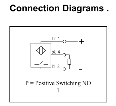

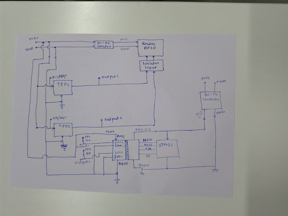

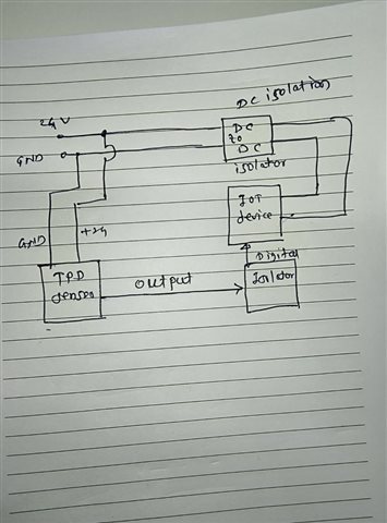

I have inductive TPD PNP sensor, Part No # NI75U-Q80-VP4X1-H1141 connected via Isolator IC as input to IoT device. See the block diagram.
I want to make another Embedded MCU based device to get health of TPD sensor and want to detect fault conditions.
1) Sensor not powered ON
2) Sensor Short
3) Output line/wire break from isolator and floating
there are the three fault conditions for my logic.
So I want to connect one more mcu based device and want diagnose these details either by power path or output path.
I thinking to use ISO1228 on output line which has output either parallel mode or serial mode which I can use to MCU for analysis. Is it possible
to detect these above mentioned conditions by using this ISO1228?
  • I want to meet these logic. Is it possible

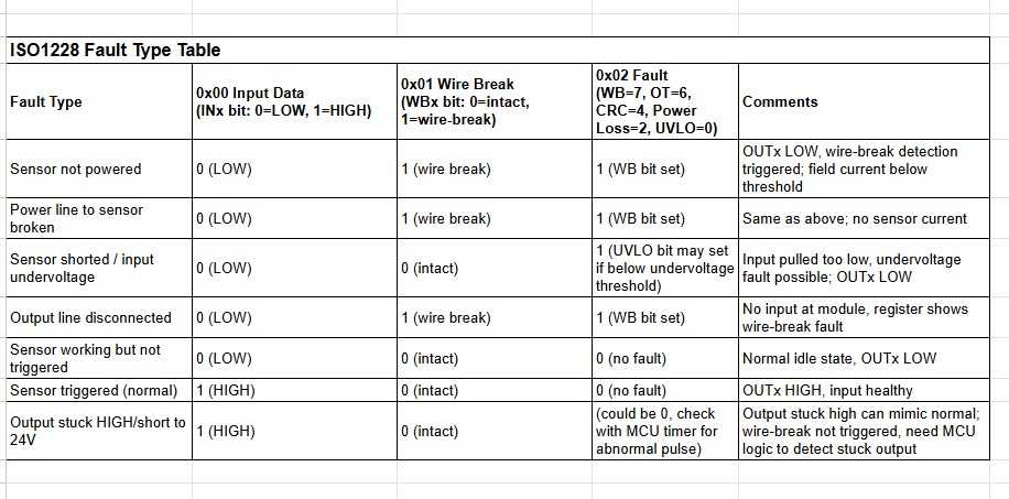

    Scenario/ Fault Type ISO1228 OUTx (GPIO Pin Input) SPI `IN_STAT` Bit SPI `DGN_STAT` Bit Comment
    Sensor not powered LOW 0 `OW_Dx = 1` Open-wire bit set, no input voltage, OUTx is LOW
    Power line to sensor broken LOW 0 `OW_Dx = 1` Same as above
    Sensor shorted LOW 0 `UV_Dx = 1` Input is pulled too low, undervoltage fault
    Output line disconnected LOW 0 `OW_Dx = 1` No voltage seen at input, OUTx remains LOW
    Sensor working but no trigger LOW 0 `OW_Dx = 0` No fault, just idle low — logic LOW
    Sensor triggered (normal) HIGH 1 `OW_Dx = 0`, `UV_Dx = 0` Everything healthy, sensor outputting 24V → OUT HIGH

  • Hello Sudeep,
    For the first 3 fault conditions:
    1. Sensor not powered ON - The ISO1228 could detect of the field side AVCC/AVSS has lost power and will report it to the fault register. This may correspond to the sensor being powered off if they share the same power rail, but it will depend on system design.
    2. Sensor Short - A short from the sensor will likely look the same as a valid logic input for the ISO1228. You could consider using another isolated device or channel of the ISO1228 to monitor if the sensor is stuck or shorted.
    3. Output line/wire break from isolator and floating - This is supported. The ISO1228 has integrated wire-break detection and can detect if the connection to sensor is removed or broken.
    The truth table above should be correct. Unless the sensor is shorted to VCC which will look like a valid logic signal to the ISO1228. The fault register can be monitored to detect which channel has a fault condition.
    Andrew
    Sensor not powered LOW 0 OW_Dx = 1 Open-wire bit set, no input voltage, OUTx is LOW
    Power line to sensor broken LOW 0 OW_Dx = 1 Same as above
    Sensor shorted LOW 0 UV_Dx = 1 Input is pulled too low, undervoltage fault
    Output line disconnected LOW 0 OW_Dx = 1 No voltage seen at input, OUTx remains LOW
    Sensor working but no trigger LOW 0 OW_Dx = 0 No fault, just idle low — logic LOW
    Sensor triggered (normal) HIGH 1 OW_Dx = 0, UV_Dx = 0 Everything healthy, sensor outputting 24V → OUT HIGH
    Output stuck HIGH / short to 24 V HIGH 1 OW_Dx = 0, UV_Dx = 0 Warning Looks like normal HIGH — use MCU timer to detect
  • Hi Andrew,
    Most of the above points look correct. One comment in your table below.
    Sensor not powered LOW 0 OW_Dx = 1 Open-wire bit set, no input voltage, OUTx is LOW - This is partially true. A small resistance is needed accoss the sensor in order to have some current draw which the ISO1228 accepts as the sensor is connected. Please see 8.2.3.1.3 Wire-Break Detection for more details.
    The other comments seem to match datasheet recommendations and the configurations of both EVMs. Please let me know if you have further questions.
    Andrew

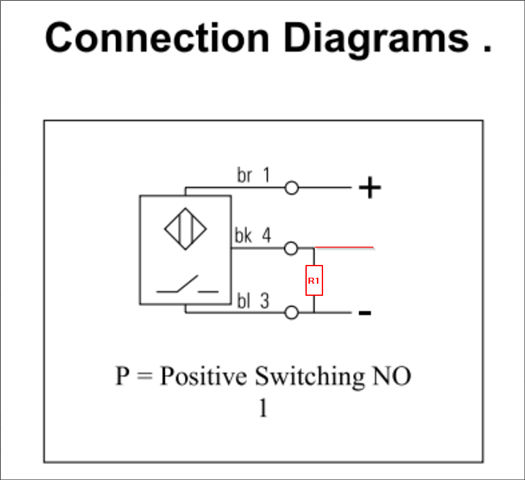

  • Hello Sudeep,
    One quick clarification, when I said "small resistance" I mean a "small current" should be across the sensor in the OFF state to indicate that the sensor is still connected when OFF. This is typically around 50koms (24V/400uA = 60k). The small current needs to be above the 245uA threshold (wire break detection threshold) in order to trigger the fault.
    The resistance needs to be in parallel with the sensor. See the section on page 2 "Proposed solution for wire-break detection and diagnostics" (How to implement wire‐break detection and diagnostics in isolated digital inputs (Rev. A)).
    Andrew

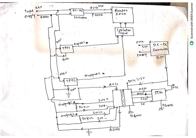

  • Hello Andrew,
    Thank you once again for your guidance.

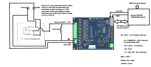

    I have reviewed all our previous conversations and the documents you suggested. Based on my understanding, I have drawn the final block diagram and shared it here for your confirmation. Please check and let me know if my understanding is correct.
    In this design, I am using two sensors, each with an output line (Output1 and Output2) connected to the RFID reader through an isolator. Additionally, Output1 is connected to IN0+ of the ISO1228, and Output2 is connected to IN1+ of the ISO1228. I am using two channels. A 50 kΩ resistor is placed across IN0+ and IN0-, and another 50 kΩ resistor is placed across IN1+ and IN1-.
    I have a couple of follow-up questions:
    1. Sensor not powered – As per my understanding, AVCC is directly connected to the sensor power supply, and sensor ground is connected to AGND. So, if the sensor is not powered or if its supply wire breaks, then the SPI IN_STAT bit should be 0 and OW_Dx = 1. Is this correct?
    2. Installation layout – All devices and the ISO1228 circuitry will be installed inside a railway location box near the control panel. I have attached images for reference. The PNP-type TPD sensor will be installed on the train track to detect wheel count. From the panel, only +24 V supply, GND, and the sensor’s output wire will run to the sensor; the output will return to the location box. In the block diagram, only the sensor is outside, and all other components are inside the location box near the control panel. Can you confirm if my understanding is correct, and whether this setup will allow detection of whether the sensor is powered or not?

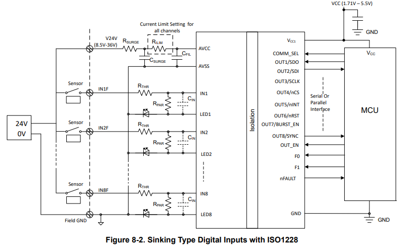

  • Hello Sudeep,

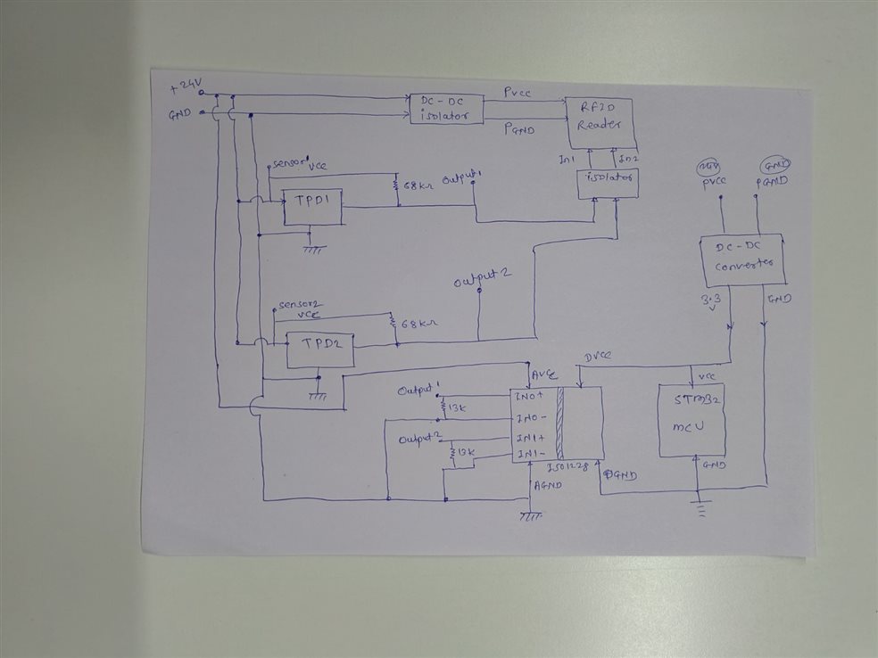

    The block diagram looks good. One comment: RPAR should either be 13k or 9.76k to set the current limit. 50kohms is to high for this.
    As for the other questions see below:
      1. If the ISO1228 power connection is maintained and the sensor is not powered, then yes, the wire break but would be triggered.
      2. If the ISO1228 itself looses power, then the field power loss bit would be triggered and not wire break.
      3. AVCC and the sensors can use the same power supply. AVCC can also be powered from an independent supply if needed.
      1. Yes, I believe your understanding is correct. Although the TPD sensors will need a small current ~400uA  draw when the switch is open to indicate that it is connected and powered (wire-break detection current in the datasheet). This can be done with a resistor from 24V to OUTPUT in parallel with each TPD sensor as discussed in the previous reply.

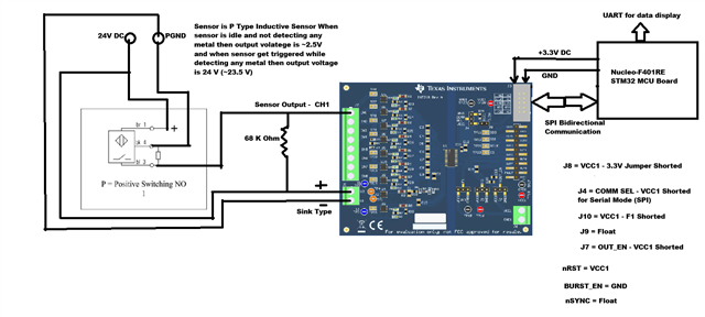

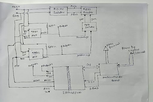

  • Hi Andrew,
    I have shared here two block diagrams need your suggestion which one is correct understanding.
    Block Diagram 1 :
    So, based on your explanation, in the diagram I shared earlier, the 50 kΩ resistor should be replaced with either 13 kΩ or 9.76 kΩ. Also, it is not connected between IN0+ and IN0- (Output and AGND), but instead between IN0+ and the sensor power +24 V, correct? And IN0- should remain connected to AGND as it is. same for second sensor.
    Block Diagram 2:
    The 50 kΩ resistor should be replaced with either 13 kΩ or 9.76 kΩ.
    It should be connected between IN0+ and IN0− (Output and AGND).
    Additionally, a small resistor of approximately 68 kΩ should be connected between the 24 V supply and the sensor output.
    Apply the same configuration for the second sensor.
    One more point — if I connect this  resistor between the sensor power and IN0+ (sensor output), the isolator in the device will always see a HIGH state. Currently, it stays LOW when there is no event, and goes HIGH only when an event occurs. Is my understanding correct?
    If that’s the case, then I’ll need to update the RFID reader code logic, because at present the reader interprets LOW as the idle condition and HIGH as the event. Adding this resistor would reverse that logic.because we have no added any pullup register on input sense and sensor also PNP.
    Please see both diagram and share which one understanding is correct. Also second question about logic state also important for my understanding so please guide.
    Waiting for your forthcoming response. I have ordered the ISO1228EVK also for testing so before that I need to clear my doubts.
  • Hello Sudeep,
    From my understanding the second diagram is the correct setup of your system using ISO1228. From my understanding your sensor is similar to the following diagram (please share a more accurate picture if it is not correct):

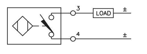

    For this type of sensor the PNP inductive sensor will "switch" to a short when proximity is detected. The ISO1228 is designed to work with sensors like this and the connection is as simple as shown in the datasheet.
    All that said, your second diagram looks good.
    Andrew

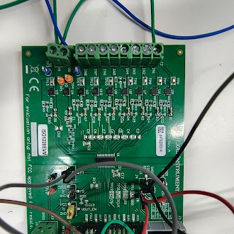

    Thank you for all your support. I have received the ISO1228EVM board and completed some basic testing following the connection details shown in the shared block diagram.
    In the block diagram, I am using a Nucleo-F401RE board connected via SPI to the ISO1228EVM. The secondary side 3.3V power supply for the ISO1228EVM is provided by the Nucleo-F401RE board, which itself is powered by the 5V USB supply from my laptop.
    I am reading SPI registers 00h, 01h, and 02h, and have built logic to extract all the status bits. The results are sent to a serial terminal via the UART of the STM32 board. The output I am getting is:
    Inputs: 00000000<LF>
    WireBrk: 00000000<LF>
    Faults: 00000000<LF>
    Ch1: OFF (Idle/Not triggered)<LF>
    <LF>
    Ch2: OFF (Idle/Not triggered)<LF>
    <LF>
    Ch3: OFF (Idle/Not triggered)<LF>
    <LF>
    Ch4: OFF (Idle/Not triggered)<LF>
    <LF>
    Ch5: OFF (Idle/Not triggered)<LF>
    <LF>
    Ch6: OFF (Idle/Not triggered)<LF>
    <LF>
    Ch7: OFF (Idle/Not triggered)<LF>
    <LF>
    Ch8: OFF (Idle/Not triggered)<LF>
    <LF>
    --- FAULT bits: WB:0 OT:0 CRC:0 PL:0 UVLO:0 ---<LF>
    On the input side, I am providing 24V as per the block diagram, with a 68kΩ resistor connected between the sensor outputs and the 24V supply, as shown.
    I have set the COM_SEL pin to VCC for serial communication mode, with F0/F1 pins both LOW/GND, and OUT_EN enabled (connected to VCC). However, no valid data is read via SPI in this setup.

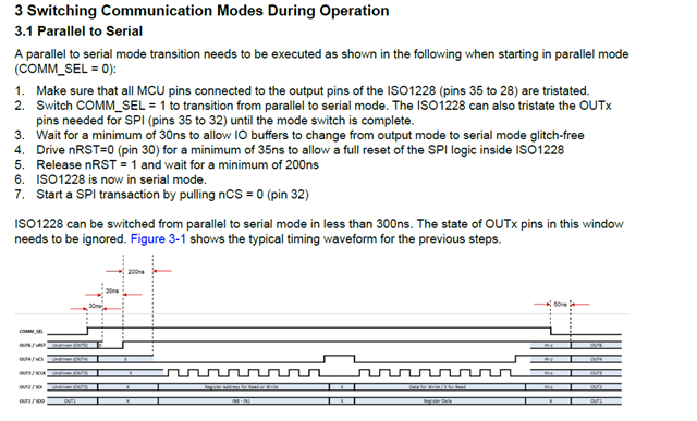

    In another test, I used parallel mode by setting COM_SEL to GND. Here, I observed unusual behavior: when the sensor output is connected to CH1 of the ISO1228, I get 3.3V, and when disconnected, 0V. But when connected to CH2, the voltage reads approximately 0.833V, dropping to 0V when disconnected.
    I would like to understand this behavior better and would appreciate your guidance. I have shared the block diagram and my STM32 code for reference.
    Please advise if I am missing or doing anything wrong.

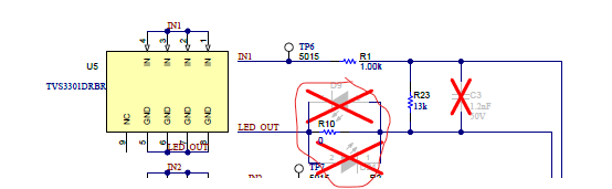

  • Hello Sudeep,
    Thank you for coming back! Since we are moving into more of a debug related discussion; I would like to confirm the operation of the EVM without going too far into the coding.
    Before we start, please note the following:
    1. There are two EVMs for this device (the ISO1228EVM and the ISO1228DFBEVM).
      1. Assuming you have the ISO1228EVM, the board can be configured in either sink or source mode based on the connection of V1 (blue test point) and V2 (orange test point).
    2. LEDx pins are tied together and connected to V1.
    3. A rectifier bridge will ensure AVCC = 24V and AVSS = 0V when V1 and V2 are connected.
      1. The device is in SINK mode when V1 = 0V and V2 = 24V
      2. The device is in SOURCE mode when V1 = 24V and V2 = 0V
    Now the simplest way to confirm the operation of ISO1228 EVM:
    1. Disconnect the sensors and test the EVM by itself in parallel mode
    2. A single channel can be tested easily by connecting IN1 to either 24V or GND and observing OUTx (in parallel mode).
      1. In SINK mode a short from INx to 24V will result in a OUT1 = 3.3V or 'HIGH'
      2. In SOURCE mode a short from INx to 0V will result in a OUT1 = 3.3V or 'HIGH
    3. Connect the MCU and test the device in serial mode. Repeat the same process by shorting IN1 and confirm the registers are reading a high at IN1.
    Andrew
  • Hello Andrew,
    As you suggested I have checked EVM by itself in parallel mode. I am using ISO1228EVM.
    1) In SINK mode a short from INx to 24V will result in a OUT1 = 3.3V or 'HIGH'
    2) In SOURCE mode a short from INx to 0V will result in a OUT1 = 3.3V or 'HIGH'
    Both tests are working as you mentioned above.
    In Serial Mode , I have kept settings as below,
    COM_SEL = connected VCC = Serial Mode
    F0 = Left open = Float
    F1= connected to VCC
    nRST (OUT6) = High = Connected to VCC.
    BRST_EN (OUT7) = GND
    OUT_EN = VCC
    I have done connection in Sink mode.
    LEDx pins are tied together in my EVM but not showing any connectivity between V1 and LEDx pins.
    I am getting result now as below
    Inputs (0x00): 00000000<LF>
    WireBrk (0x01: 00000001<LF>
    Faults (0x02): 00000010<LF>
    Filter (0x03): 00000011<LF>
    Ch1: FAULTY (Wire Break)<CR><LF>
    Ch2: OFF (Idle/Not triggered)<CR><LF>
    Ch3: OFF (Idle/Not triggered)<CR><LF>
    Ch4: OFF (Idle/Not triggered)<CR><LF>
    Ch5: OFF (Idle/Not triggered)<CR><LF>
    Ch6: OFF (Idle/Not triggered)<CR><LF>
    Ch7: OFF (Idle/Not triggered)<CR><LF>
    Ch8: OFF (Idle/Not triggered)<CR><LF>
    Faults raw: 0x02 [WB:0 OT:0 CRC:0 PL:0 UVLO:0] UnknownMask:0x02<CR><LF>
    Here strange result Ch1 shows faulty in both condition
    a) When Ch1-Ch8 connected to 24V
    b) When Ch1-ch8 connected to 0V
    Same result as above if I connected either 24V to any input channel or 0V to any output channel.

  •  Hi Sudeep,
    Thank you for all the details. Thank you for confirming operation in parallel and serial modes.
    This is okay. The EVM connects V1 to LEDx_out through Schottky diodes. A multimeter would not read the nodes as continuous due to the diodes.
    Faults (0x02) corresponds to a reserved bit (see register map). This should not be written to and can be ignored.
    The input register should still toggle when shorted to 24V. Using a wire is a crude way to force the output high and will look like a wire break to the fault register.
    Therefore, the EVM may detect a wire break fault since we are not using a standard sensor (where there is a 68kΩ wire-break resistor in parallel with the switch).
    The CH1 wire break fault should disappear when a 68kohm resistor is connected to 24V (and the CH1 input is not shorted).
    Andrew
  • Hello Andrew,
    Thanks once again for your guidance.
    Now have connected EGT18X08AP024-2000L proximity sensor (PNP) metal detector sensor instead of sensors details shared earlier because
    which available with me at this moment.
    As I discussed earlier Testing in parallel mode is working fine even after actual sensor connected to CH1
    Now testing in serial mode :
    Input Side :
    So I have connected 68 Kohm reister in between sensor output and 24V.
    I have made connection in sink mode.
    Output Side :
    F0 = Float
    F1 = VCC = HIGH
    nSYNC(Out8) = Float
    nRST (OUT6) = VCC = HIGH
    BURST_EN = GND = LOW = Normal Mode
    COMM_SEL = VCC = HIGH
    OUT_EN = VCC = HIGH
    Registers reading : 0x00, 0x01, 0x02
    Result :
    WireBrk: 00000001<LF>
    Faults: 00000010<LF>
    Filter: 00000011<LF>
    Test cases performed :
    1) I have connected sensor output to CH1 ( with 68 Kohm pulled up to 24V (V2))
    Measured voltage at CH1 and V1(FGND) = 2.6 V when no trigger on sensor. All other Channels (CH2-CH8) having 0.140 V with respect to V1(FGND).
    Measuerd voltage at CH1 and V1(FGND) = 22.82 V when trigger on sensor.
    Result showing by SPI :
    2) I have connected sensor output CH2(with 68 Kohm pulled up to 24V (V2))
    Measured voltage at CH2 and V1(FGND) = 2.6 V when no trigger on sensor. All other Channels (CH1 & CH3-CH8) having 0.140 V with respect to V1(FGND).
    Measuerd voltage at CH2 and V1(FGND) = 22.82 V when trigger on sensor.
    So even when I am teting same process with each induvidual channles then also getting same reesult using SPI.
    Parallel mode is working fine with each channel.
    I measured resistance between Sensor output and V2(24 Volt pin) while input supplu switched off and sensor output free from CH1 and its 68.3 KOhm showing.
    So that means my parallel registance to switch also fine.
    I am confused where I am doing mistake. Because All time result is same in serial mode as mentioned above.
    Attaching video also for your reference
  • Hello Sudeep,
    Thank you for showing the videos let me review and get back to you.
  • Thanks Andrew, Waiting for your response and quick guidance.
  • Hello Sudeep,
    I have a meeting today to review this. Thank you for your patience. I'll reply EOD.
  • Hello Andrew, Thanks for update.
  • Hi Andrew, Thanks for the update. And yes your forthcoming response will very helpful for me.

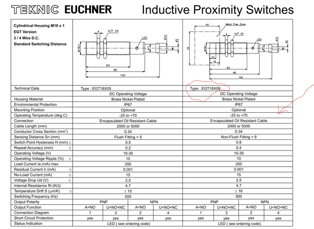

  • Hello Sudeep,
    After review, I do not have a good understanding of what the sensor does.
    The datasheet that I find online for this sensor shows the following connection diagram. Is the below diagram correct?
    Can you show on your schematic:
    1. Can you tell me on the schematic, which is pin 1, 3, and 4? Also how are these pins connected to ISO1228 in the schematic?
    2. What is the expected behavior of the sensor and what is the expected behavior of these pins?
    3. What is the state of the switch when the proximity is detected and not detected and on which pins is this observed?
    Andrew
  • Hi Andrew,
    I am sharing here image which can give you some clarity of connections which is I am using during this testing.
    I have attached my code and debug logs also for better clarity.
    Inputs: 00000000
    WireBrk: 00000001
    Faults: 00000010
    Filter: 00000011

  • Hello Sudeep,
    Thank you for the details. Based on the datasheet for the sensor it looked like br 1 is sensor supply, bk 4 is sensor output and bl 3 is sensor ground?
    But in the connection diagram it appears that the output and ground connections are flipped. Can you confirm which one is correct?
    If my understanding is correct, please connect the sensor output (bk 4) to CH1 of the ISO1228 and sensor ground (bl 3) to ISO1228 ground and test again.
    Adrew
  • Hello Andrew,
    Sorry Its my mistake I have drawn wrong connection diagram. But I am following correct connection as per datasheet and as you mentioned above.
    I have attached correct diagram again here which is I am following. And I shared logs and issues previously is captured with this corrected diagram only. So issue is still persist.
  • Hello Sudeep,
    Please remove the 68kohms resistance for now. This resistance is meant to be in parallel with the sensor while the sensor is 'open'. The below questions are trying to identify when the sensor will create a short between (bk 4) and (bl 3).
    Andrew
  • Hello Andrew,
    After remove 68 K ohm. Same result getting no any change.
    I have moved Sensor ouput at CH3 from CH1 but same result WB latched to CH1.
    Same I moved Sensor Output from CH3 to CH4 but same result as above. Only When I Switch mode from serial to parallel then All result is 00 but as per datasheet parallel mode is working. When I sensor output (CH1) High then OUT1 High and When Sensor output at CH3 and High then OUT3 his high and low when Sensor output Low.
    I have given here some details as answers of your questions,
    EGT18X08AP024-2000L proximity PNP (sourcing) sensor → ISO1228 must be configured for “sink input mode.”
    How it wires up (for PNP proximity sensor) :
    • Sensor Pin 1 (brown, +V): Connect to field supply +24 V (AVCC rail).
    • Sensor Pin 3 (blue, 0V): Connect to ISO1228 field ground (AVSS).
    • Sensor Pin 4 (black, output): Connect to an ISO1228 IN1 channel pin.
    Expected behaviour of the sensor & pins :
    1) No target present : No metal detected to proximity sensor :
    Expected behaviour :  Sensor output (pin 4, black) is OFF/LOW / Open
        Observations :
        IN1 sees ~0 V → without 6.8K ohm between +24V and Output,
        IN1 sees ~2.5 V → with 6.8K ohm between +24V and Output
    2) Target detected : Metal detected to proximity sensor :
    Expected behaviour :  Sensor output (pin 4, black) is ON/High / Close
       Observations:
       Sensor output (pin 4, black) sources +24 V → So voltage at IN1 input1 of ISO1228EVM is ~23.8V without 68k Ohm resister between Ouput and +24V
       Sensor output (pin 4, black) sources +24 V → So voltage at IN1 input1 of ISO1228EVM is ~23V with 68k Ohm resister between Ouput and +24V

  • Hello Andrew, As I have shared all details of connection please check and guide further.
  • Hello Sudeep,
    The connection diagram looks good now. I understand that the ISO1228 and sensor communicate in parallel output mode but no communication in serial.
    Serial mode should be functional if parallel mode is working well. There must be an issue with either the code or the SPI connection. I do not undertand the code well enough, but issue is likely with how the device is read since the data is not changing. Please also make sure that the ISO1228 Reset pin is being asserted before reading SPI addresses.
    How to Dynamically Switch Between Serial and Parallel Modes Using ISO1228 is a helpful document to explain the SPI function.
    Andrew
  • Hello Andrew,
    I have understand once again all the control pin sequence before and after serial mode start. And I have made some changes in my code and I am sharing here algorithm for your reference. You can also validate below section in document vs my algorithm
    Control Pins set by Jumpers on board:
    Burst_EN = GND (Jumper set on Board)
    SYNC = VCC1 (Jumper set on Board)
    F1 = VCC1 (Jumper set on Board)
    F0 = Float
    COMM_SEL = controlling by MCU
    OUT_EN = controlling by MCU
    nRST = controlling by MCU
    Sequence diagram (per-pin timeline + SPI bytes) :
    participant MCU
    participant ISO1228
    Note over MCU,ISO1228: Serial START (iso_serial_start_sequence)
    MCU->ISO1228: COMM_SEL = HIGH
    MCU->ISO1228: nRST = LOW (hold 1 µs)
    MCU->ISO1228: nRST = HIGH (release)
    Note over MCU,ISO1228: wait 2 µs for SPI logic
    MCU->ISO1228: OUT_EN = HIGH
    Note over MCU,ISO1228: Now ready for SPI transfers
    Note over MCU,ISO1228: ---------- SPI READ (reg 0x00) ----------
    MCU->MCU: iso_cs_set(LOW)    //   CS asserted
    MCU->ISO1228: delay_us(1)
    MCU->ISO1228: MOSI: [0x00, 0x00]    //  tx[0]=reg(0x00 MSB=0), tx[1]=0x00
    ISO1228->MCU: MISO: [rx0, rx1]         // rx1 = register value (per code)
    MCU->MCU: iso_cs_set(HIGH)            // CS deasserted
    MCU->MCU: process rx1 as value
    Note over MCU,ISO1228: ---------- SPI WRITE (reg 0x03 <- 0xBB) ----------
    MCU->ISO1228: MOSI: [0x83, 0xBB]        //  tx[0]=(0x80|0x03), tx[1]=0xBB
    ISO1228->MCU: MISO: [rx0, rx1]              //  device returns two bytes (status/prev)
    MCU->MCU: optionally log rx0,rx1
    The complete algorithm is shared in .docx file for your reference please check and tell me where I have exactly doing wrong.
    ISO1228 SPI Flowchart & Algorithm.docx

  • Hi Sudeep,
    I must admit that my coding skills are simple. I will need some time to review the documents.
  • Hello Andrew,
    I am now able to read SPI resister correctly. I missed CS transaction during Address frame and data frame separate. Now its correct and getting below readings. Please guide about SYNC pin also during address fame should 1 and during data frame it should 0 as read in the documents. Is correct?
    IN=0x01 WB=0xFE FAULT=0x80   --- This is when sensor have proximity detected (Event due to metal detection)
    When
    1) CH1 connected to sensor Output
    2) V2 connected to +24V
    3) V1 connected to FGND
    4) Sensor vcc connected to +24V
    5) Sensor GND connected to FGND
    6) Resister 68K (or 100K both tested same output) connected between Sensor output and +24V
    IN=0x00 WB=0xFF FAULT=0x80   --- This is when sensor Idle
    But sensor idle and 68k register in between +24 and Output of sensor then WB should show WB = 0xFE
    this is not happening. Please confirm is I have connection wise correct to get earlier table output discussion.
  • Hello Sudeep,
    I am happy that you got this working! Sorry I could not be more helpful.
    Yes, that is correct.
    This makes sense if only channel 1 is connected. The other inputs will read as faulted.
    Yes, I agree. Channel 1 should not read a wire break fault. I mentioned this previously; however, it may have gotten lost in our long discussion. Most sensors have a Wire Break resistance (R_WB) across the input terminals that read above 60kohms when the sensor is open.
    The ISO1228 reads the current drop over the R_WB to indicate that the sensor is still connected and open/inactive. Earlier, I was assuming that your sensor did not have this resistance which is why I recommended a 68kohms (R_WB) should be placed in parallel with the sensor's switch terminals.
    Please check your sensor's off-state resistance and datasheet and apply a resistor if needed.
    Andrew
  • Hello Andrew,
    Actually you have already provided me great help and thanks once again for your great help.
    I had tested by removing 68K resistance also and was connected direct output at CH1 but same issue. Actually when sensor is idle that time wire break should not detect at CH1.
    Update : I have measured Internal resistance in sensor off state between sensor supply and output by DMM but getting open. no resistance found.
    I have shared here screenshot of parameters of sensors from datasheet
    So it means we need to add external pull -up resistance between 24V and Output. Correct?
    Please suggest some test bench to detect issues regarding all resisters in ISO1228 (Input, Wire-Break and fault)  and to know where I am doing wrong.
    Sudeep
  • Hello Sudeep,
    The extra resistance is not always a pull-up resistance. It will depend on the sensor type.
    If I am understanding correctly, your sensor has no wire break resistor. The diagram shows some external resistance to be applied at R1. Please install the wire-break resistor across pins 3 and 4 as shown below (R_WB = R1 = 68kohms), this should make the sensor read 68kohms in the off state. Let me know the results.
  • Hello Andrew,
    Thanks for your support.
    I have done this experiment also. I have Connected 68 k resistance between Output and ground but same result.
    When I proximity gets any event then
    and When proximity doesn't having any event then
    I have changed resistance also and used 90 k  according to some calculations but same issue.
    I have shared the EVM manual once again here. Can you guide me some test method or test bench to validate hardware also.
    I assume if I am getting input register value properly then my SPI working is proper. And also I have already shared details of flowchart and control pin sequence by algorithm that I have implemented as per datasheet in Normal SPI mode. I am not using burst mode.
    ISO1228EVM.pdf
    Sudeep
  • Hello Andrew,
    Its good news, I have done successfully , I am getting correct reading now, Please see log below,
    IN=0x00 WB=0xFF FAULT=0x80 (EFF=0x00)<CR><LF>   ---  When Wire Break
    IN=0x01 WB=0xFE FAULT=0x24 (EFF=0x24)<CR><LF>  ---  When Event on sensor
    IN=0x00 WB=0xFE FAULT=0x80 (EFF=0x00)<CR><LF>  --- When no Event on sensor
    So Now I can implement the logic mentioned in table that we have discussed in which I mentioned different cases.
    I found problem is that you can see the EVM manual in my previous reply. I have seen in schematic, where LED is not available on EVM and by 0 ohm register return path directly connected to ground so wire break not detected because the minimum threshold current not getting. So I removed this 0 ohm register and its working now. See the image below
    Thank you so much once again for your continuous support. I will approach again if I will get any issue or need any other help regarding it after my logic implementation complete with my device. Its great help.
  • Hi Sudeep,
    This makes sense, removing the 0-ohm resistor would and connecting to the LED_OUT directly for each channel would enable the wire-break feature. Thank you for posting the solution to your problem.
    Feel free to create a new thread for your next question and link this one as a reference.
    Andrew
