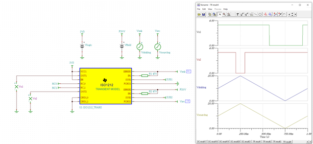

  • Hi Andrew,
    I don't have access to evaluation hardware at the moment, so I have been tinkering with the simulation model.
    I am back in the office and ran the following test. Much more accurate representation of what I was trying to understand.
    Once channel is in SINKING (FGND1 tied to 0V) configuration, the other is in SOURCING (SENSE2 tied to 20V).
    A variable voltage (0 ~ 20V) is applied to SENSE1 / FGND2 respectively, and a transient simulation was run.
    As you can see, the sourcing configuration, as I understand the implementation, does not follow the ΔV thresholds like the sinking implementation does.
    Is this a simulation artifact, or actual device behavior? (I need to know before I get my hands on some hardware)
  • Hello Katafuchi-san,
    Thank you for the clarification and sorry for the delay. The above diagram indicates that the ISO1212 is operating correctly for sink mode. This is okay since ISO1212's input channel is receiving a voltage from a different device.
    For source mode, the input is providing the 20V to the sensor. Therefore, the source input is meant to be connected to a switch/load. There is no practical reason for the input to see a ramping voltage since a switch would only be open or closed. The correct application would be to short Vsrc to Ground using a switch as you had previously. Vo2 should be 3.3V when the input is shorted.

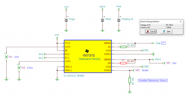

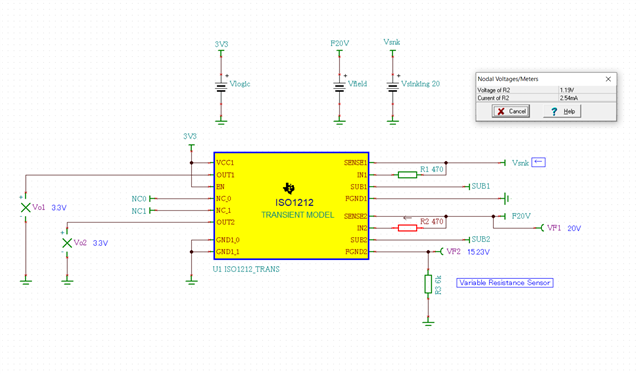

  • Hi Andrew,
    Re-did the simulation to avoid voltage sources where they don't make sense.
    Here, I have FGND2 tied to GND through a resistor.
    This resistor represents the resistivity of some sensor.
    As you can see, if the resistor is 6kΩ, the ΔV = SENSE2 - FGND2 = 20V - 15.23V = 4.77V.
    This is clearly below VIL and the OUT2 should be LOW. But as you can see, Vo2 is showing 3.3V.
    Now if we change the resistance to 10kΩ we get the following.
    The ΔV = SENSE2 - FGND2 = 20V - 16.84V = 3.16V.
    This is below VIL and OUT2 is as expected LOW.
    But the point I am trying to make is the datasheet indicates a VIH of ~8.25V while the simulation is showing OUT2 = 3.3V at 4.77V, which is far below VIL, not to mention VIH. Is this just an artifact of the simulation model, or representative of actual device behavior?
    I believe this is a possible characteristic of the simulation since the loads used for the sensor are too small in resistance.
    In source, the standard defines that sensors should consume 2.25mA or less current. Therefore, the R3 resistor which is used to simulate sensor resistance should be increased from 10kohms to 16kohms or higher.
    Andrew
