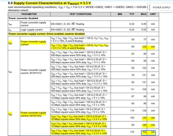

Hello experts,
I have question regarding the ISOW1432 transceiver.
If the customer will use it with the following conditions (below), the internal isolated power supply will support the required max current as appear in the table below?
