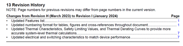

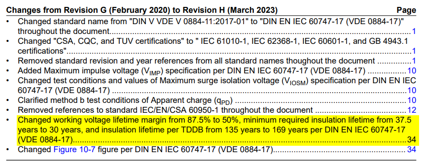

    The main reason of this change is due to the change in standards and requirements. Please see the revision history from sllsep4h. The datasheets were recently updated and therefore does not include all of the revision history, I see how this can be confusing as well.

    1) Ther is no information in the revision history

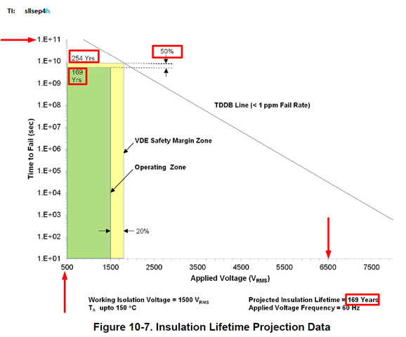

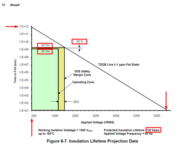

    Revision H Revision I
    Years (max) 254 54
    Years TDDB 169 36
    Time to Fail operationg(sec) ~7E9 1E9
    Time to Fail VDE safety (sec) ~1E10 ~2E9
    Revision H
    Revision I

    The reason for all three document revision changes in regards to the TDDB graph are the same. The lifetime margins and insulation lifetime parameters were changed and updated in accordance to the newer IEC standards (IEC60747-17, VDE0884-17).
    Due to this standards change, the TDDB graph had to be changed, along with updated margins and lifetime. All newly updated datasheets for isolation devices are being updated to this new standard.

    The new values are not necessarily better or worse than the previous numbers. Since the margin changed from 87.5% to 50%, the lifetime years also changed. Since the device itself did not change, there is no system impact in terms of the functionality or performance of the device.
