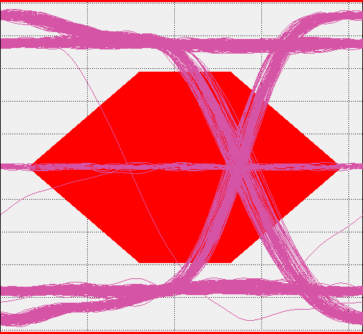

We are running USB 2.0 compliance signal integrity tests at the output of the usb port connected to the iisousb211 chip. This chip is downstream of a USB hub. The test data shows an eye mask failure and failure of number of EOP and Sync bits.
When the isolation chip was bypassed by shorting the input and output usb traces, all test parameters pass.
To rule out other issues with our circuit deign, we have repeated this test with the ISOUSB211 Eval board and seen the exact same failure.
The failure of sync bits is always 27 instead of 32 and EOP width of 3.2bits instead of 7.5-8.5bits.

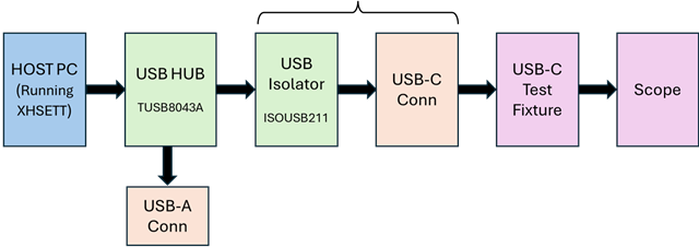

    1. This is the block diagram of the system. There are 3x usbc ports connected through the isolator chip and 1x USB-A port connected firstly to the hub. The eye diagram taken at the USB A connector is good, there is no end of packet or sync bit count failure. All ports are unconnected except the one under test while running compliance. The usb hub and isolator chips share the same PCB. It is first powered on and then connected to the host PC running HSETT
    2. The third eye diagram in the original post was taken without the hub. That test case had the eval board directly connected to the HOST PC running xHSETT.

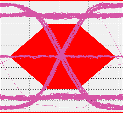

    3. That could be the case, however, we are only seeing this happen with the ISOUSB211 chip. Measuring the eye-diagram directly at the USB port of the HOST PC and the USB HUB does not show any issue. They all pass and look like the second eye diagram shown in the original post.

    Thanks for the details. Let's take this forward based on your input 2 which is stated as below:
    So this statement says that ISOUSB211 EVM when tested standalone with PC and USB-C test fixture, the eye diagram fails in scope.
