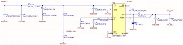

  • Hello Andrew J,
    SYS.3V3 is generated from a 24VDC to 3V3 Buck Converter based on the LT3971
    We measured all input and power supply signals on start-up, steady-state operation and shutdown. We did not observe any spiking on the power supply rail. The buck converter still seems to be functional after we replace the failed isolator, so I do not believe it to be failing.
    2 out of 6 signals are connected to an external PCB, these are connected to pull-down resistors on the connected PCB. The remaining signals are on the same PCB.

  • Hi Andrew S,
    From the information provided, I do not see anything that would inherently cause a damage to the isolator. Likely, there is some transient or power event from the high-voltage side that is causing damage or a failure after repeated stress.
    My best guess is that the large capacitors on Vout of U38 cause a large inrush current at power on due to high capacitance on the power rail. Managing Inrush Current (Rev. A) may be a helpful application note. However, I am not an expert on the IC used in U38.

  • Thank you for your feedback, Andrew.
    Transients on the 24V side seems unlikely, this has all happened in a lab or workbench setting which should have fairly clean power, we also have upstream transient protection and filtering on our boards.
    I recognise that the buck regulator is an ADI part, and you won't be an expert on it. But it's a fairly typical buck regulator with soft start so initial inrush should be minimal. I also would not expect large load transients on the 3V3 rail either.
    In our testing we have not observed any transients on either the 24V or 3.3V rails
