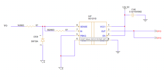

Hi,I need a clarification for this above schematic ,Can I connect EN pin directly to the VCC pin,and Can I give Field GND common or separate to input pins in the input side .

Hello Gokul,
Thank you for reaching out. Please see the below recommended layout. Please note that Pin 5 needs to be floating not connected to FGND.
Also, pins 5-8 should be separate from pins 1-4. There should be no connection between side 1 and side 2 pins. However, FGND can be common to the input ground.
Andrew
