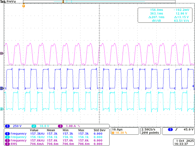

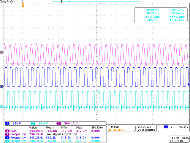

  • Dear Ma’am,
    Please find attached the DSO screen captures for the following scenarios:
    1. Output at 20 V with load – Operating frequency observed: 162 kHz
    2. Output at 32 V without load – Operating frequency observed: 344 kHz
    3. Output at 6 V with load – Observed that the low-side MOSFET is not switching
    In each case, I have measured the transformer primary winding current along with the switching waveforms of both the high-side and low-side MOSFETs.
    AC input current: ~0.3 A (measured with clamp meter, before bridge rectifier)
    DC output current: ~1.4 A @ 20 V (measured with clamp meter)
    Kindly review the attached results and advise on possible causes or next steps.
