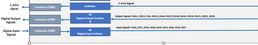

I'm designing a card which need isolators to for isolating by Digital IO and one-wire signals
Can you suggest the part numbers for that.
Also for my output of the DAC i need an isolation amplifier or isolator which want to isolate */- 4KV by means of magnetic isolation
Can you suggest part numbers for my applications
Abhishek

  • Hi Andrew,
    For my Digital IOs can i use the part  ISO6540-Q1 (4channel) or ISO6760-Q1 (6channel). I have a total of 9 digital inputs and 12 digital output signals as Digital IOs to be isolated. Also i have a one wire signal which is a single signal which also need to be isolated.
    For example, if I use two 6 channel isolator as mentioned above part number, i can use two of them to isolate my 12 output signals.
    Similarly, if I use two 6 channel isolator for my 9 digital input signals, 3 channels are left free, does any termination is required for those unused channels,
    Also can i use the same ICs of the unused signal for my one-wire signal. Does it causes any issues to my one-wire signal.
    If not possible can you suggest a single channel isolator for isolating my one-wire signal.
    Abhishek

    I am unfamiliar with the one-wire physical layer. However, from what I see online, it looks like a bi-directional protocol that is open-collector. If this is true, then the ISO1640 is needed for the bi-directional function and the open-collector style outputs.
    Andrew
