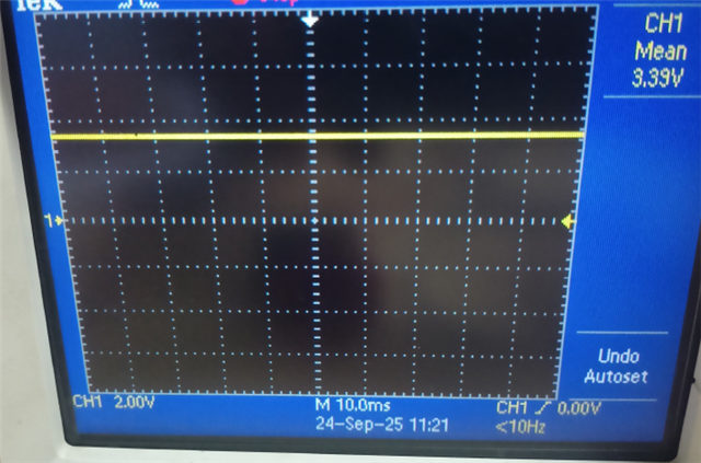

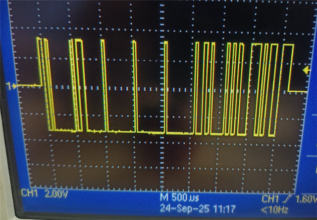

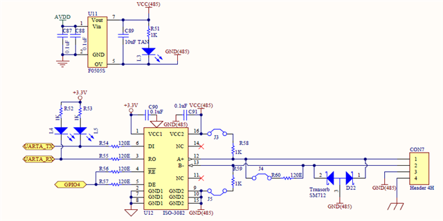

We are using ISO3082 in our one application, we have not recevied any data and got fail RO pin in ISO3082 even we use SM712 diode for external protection purpose. Please help to get solution.

    Please describe how the failure is identified. Is the failure intermittent or persistent? Is the pin 'stuck' low?
    - Card communication was fail after running of 1 month and i check in card RO pin high.
    Please include a schematic capture of ISO3082 that shows how the diode is connected,
    - where AVDD - 5V, VCC(485) - 5V
    Please provide waveforms that show the inputs and outputs to the device. Include the D, R, A and B pins in the scope capture.
    - waveform at pin A & B
    - Waveform at R pin
    Dharmendra
  • - waveform at pin A & B
    - Waveform at R pin
  • Dharmendra,
    Thank you for providing more details. The schematic looks as expected. The R pin is only enabled while RE/ is low or '0'. Is GPIO4 driving a '0' while R is being measured?
