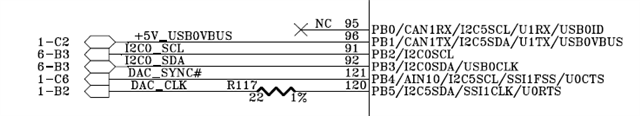

    My current non-isolated circuitry is below. First the Type B connector, where VBUS is formed (protected with a Zener and a resistor), and then below is fed to PB1 pin of the TIVA CPU (dedicated VBUS pin).

  • 1. These resistors.
    2. The application is based around a TI part, TM4C1294NCPDT microcontroller. It has a USB interface which my application uses for communication as a Device (Peripheral). The microcontroller's USB determines the device is connected to a Host by monitoring the VBUS (as any USB2.x would). Now that I am using your ISOUSB211 isolator, there is no specific VBUS signal that this isolator outputs, that is described in the datasheet as the VBUS output to the microcontroller (now that the microcontroller is physically isolated from the Host).
    My question is: what should I be using as the VBUS? Can V1OK be used in this capacity?
    The TM4C is a TI part, so you should be aware how to connect the two chips together.
    If V1OK can be used, I guess I have to convert it to 5V, as PB1 when configured as VBUS input, requires 5V level.
    I am satisfied I can use V1OK, but nowhere in the datasheet it explicitly says it can be used as VBUS. Perhaps the wording should be modified (and, yes, it is understood it won't provide the 5V power that VBUS typically supplies, but will provide the connection indication function)
