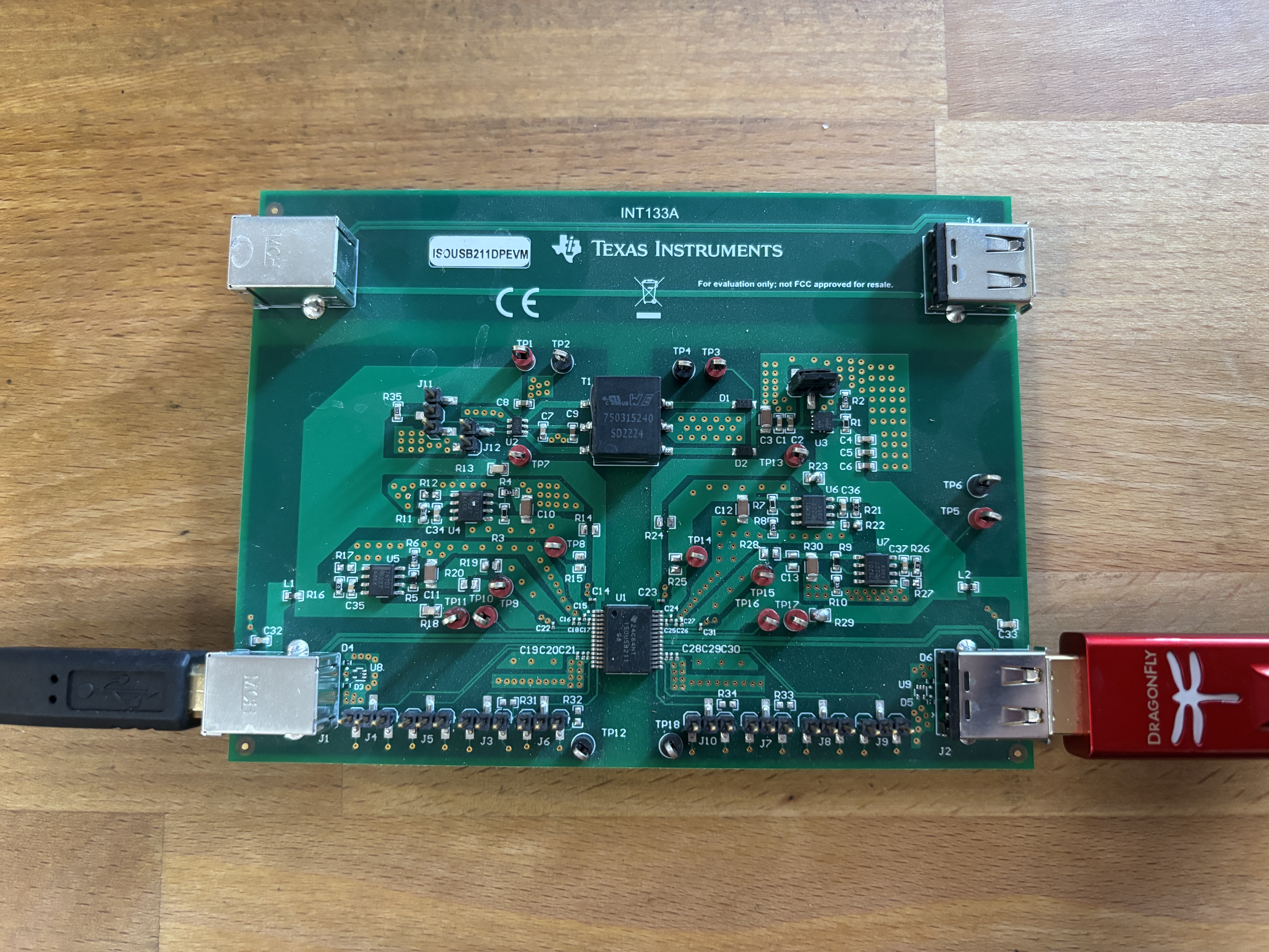

We manufacture a commercial USB galvanic isolator utilzing the ISOUSB211 and have identified a repeatable enumeration failure with the AudioQuest DragonFly Red USB DAC (Hardware v1.0, firmware v1.0.8) and a short list of other audio equipment. Yet, the majority of USB devices enumerate successfully.
The enumeration failure has been reproduced on TI's own ISOUSB211DPEVM, confirming this is not specific to our implementation. This report focuses on the DragonFly Red for its simplicity and small current consumption of approximately 40 mA @ 5.V
The DragonFly Red enumerates and operates normally when connected directly to a host without the ISOUSB211 in the signal path.
 USB Capture via Total Phase Beagle 480 (Host PC --> ISOUSB211DPEVM --> DragonFly Red)

The ISOUSB211DPEVM is momentarily negotiated (index 2), but the very first data packet is corrupted (index 3: `E3 FF`). The link then drops to Low-Speed and cycles through rapid Reset/Keep-alive sequences (indices 4–9) before falling back to a Chirp J / Tiny J failure pattern (index 10). A target disconnect follows (index 11), and one more failed chirp attempt occurs before all activity ceases.

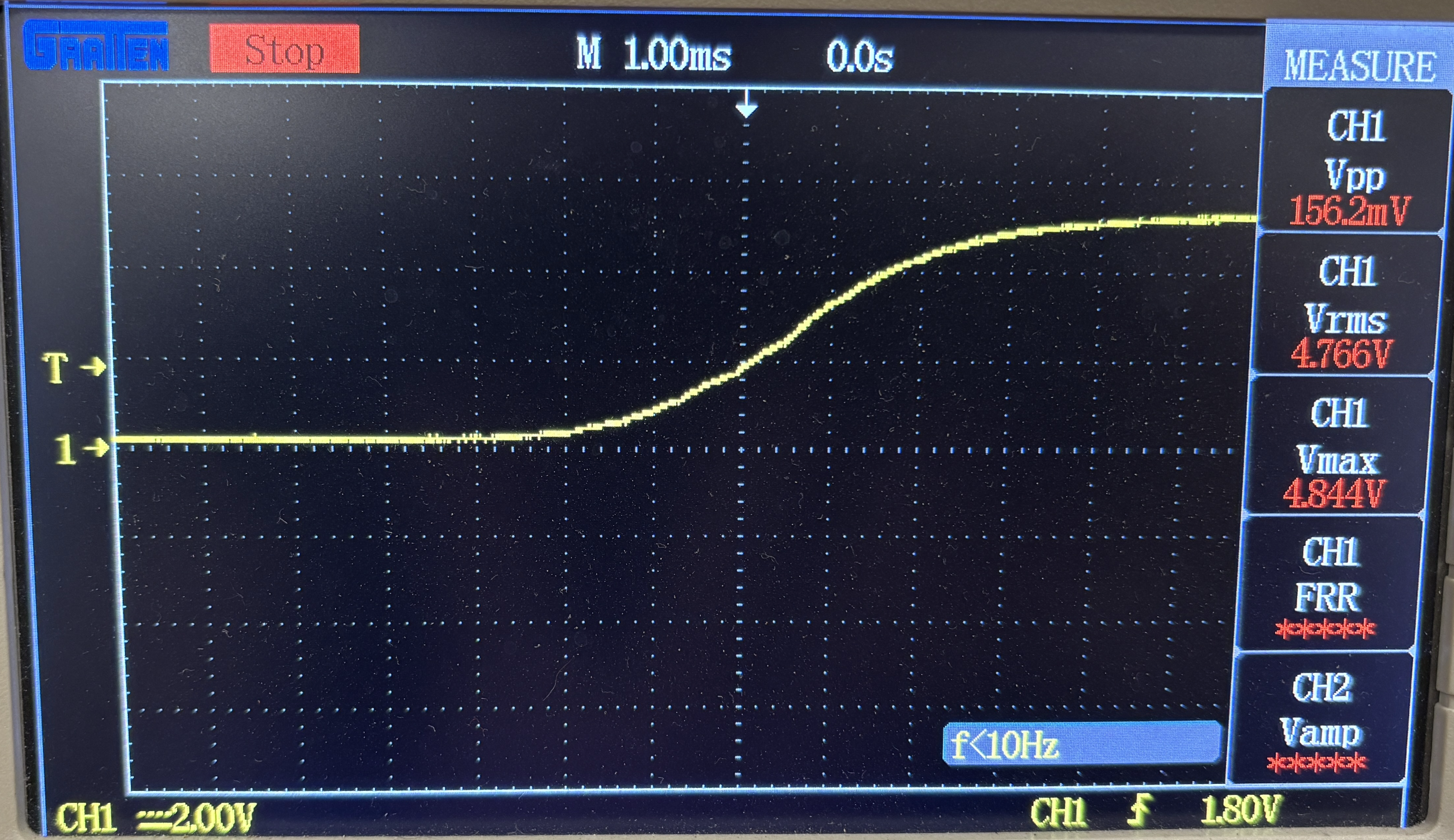

I initially suspected target 5V rail instablity during enumeration. Since we see the same behavior from our own board, I tried tripling capacitance at the target side 5V regulator (TPS73701), and at its IN and OUTPUT pins. No change.
The target 5V rail initializes smoothly, free of oscillation:

    Can you please share the zoomed in picture of the ISOUSB211 device tested on EVM which shows these failures.

    Thanks for the picture but I need a zoomed-in image of ISOUSB211 device on the EVM from where I can read the numbers imprinted on top. Can you please help with that.

    Sorry about that! The image must have been resized upon upload. Is this what you need to see?

    Thanks for the image. Allow me some time to investigate this in background.

  • Hi John,
    Thanks for the inputs.
    It operates at Full-Speed as a USB Audio Class 1.0 device with asynchronous isochronous endpoints — a standard and compliant USB 2.0 profile
    - The descriptor structure (AC interface, AS interface, format type, endpoint descriptors) is well-formed and consistent with the UAC 1.0 specification
    Unfortunately, I don't have correct expertise to comment on this currently. Neither ISOUSB211 has been tested with such profile, hence we cannot comment on if it is guaranteed to pass with such an interface.
    This is also because the ISOUSB211 works okay with other peripherals and there's no systematic issue with audio in general since you validated using Apple USBC to 3.5mm Adaptor - So there's a systematic failure only with the DragonFly's USB interface, for which I don't know the root cause for.
    This issue will need some involvement with AudioQuest as well in understanding the internal interface on how they are implementing the USB to audio coversion.
    Can you please also accept my friend request for discussing few points offline which cannot be shared on public forum.
    Varun
  • Varun,
    To be clear, the problem is not limited to the AudioQuest Dragonfly. The same enumeration failure occurs with USB equipment from other brands including RodeCaster, Teengage Engineering, and more. All such USB devices work correctly without ISOUSB211 in the signal path.
    I opened this ticket to make Texas Instruments aware of a potential issue with ISOUSB211 which should at the very least be documented in a technical sense. Is there anyone in the isolation department willing to investigate? I will be glad to ship sample hardware to Texas Instruments for a proper engineering review. Please feel free to reach out to me directly.
    John
  • Hi John,
    Apologies for the issue and Thanks for letting us know that this is a systematic issue with USB to Audio kind of converters
    We will reach out to you offline once we have more clarity on this issue ourselves. This is a first of it's kind issue that we're hearing and too with very selective peripheral hardware (USB to Audio Converters so to say)
    In the meantime, what we would like to understand is how many USB hubs budget do these USB to Audio Converts eat up in the 7 Tier USB tree
    Varun
