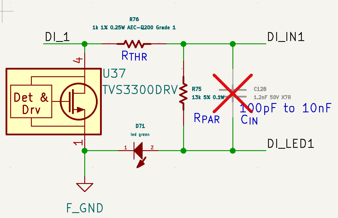

    In order to comment on what is causing this issue for you, we need see your full schematic connection showing all the pin connections rather than just IN1 and LED1.
    Also, it will really help if you have any waveform illustrations to share on how you're seeing the wire-break enabled and nINT getting pulled low along with data on INx.
    Varun
  • Hi Varun,
    attached my circuit.I send you waveform tomorrow.
    Thanks.
  • Hi Jose,
    Thanks for the schematics.
    There's no obvious red flag that I could see in the schematic connection.

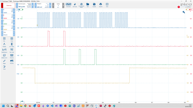

    I apologize for the delay in responding. I have attached the waveforms.
    As you can see in the circuit diagram, I have two chips in a daisy chain configuration.
    The waveforms you see correspond to a reading of the input states, the wirebreak register,
    and the fault register. Only the first input of the first chip is set to 1, the rest are floating.

    ChA: SCLK, ChB: MOSI, ChC: MISO, ChD: CS.
    I've also noticed that the Fault pin goes to level 0 (logic active) when all inputs are
    floating or connected to ground, and only goes to 1 (logic inactive) when all inputs are
    connected to 24V. This doesn't seem like the correct behavior, does it? Furthermore, in the first case,
    the value of the fault register is 0, which doesn't accurately reflect the pin's state.
    Regards.

    Apologies but the waveform I'm unable to retrieve any root cause form the waveform that you shared above.
    In order to debug this step by step and not diverge in all directions, let's start by the issue reported first.
    Please probe using an actual oscilloscope and probe setup where we see INx and nINT along with nFAULT at the same time to see the actual Input Output behavior
    Varun

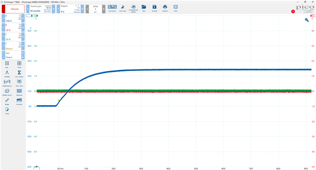

  • hI Varun,
    CHA Input IN1, CHB nINT, CHC Fault. I have tested it without pull up. Then I repeat the test with 4k7 pullup in nINT pin with same waveform.
    I have verified that if it does not read via spi, nInt remains low, which, although not explicitly stated in the datasheet,
    seemed to be the expected behavior.
    The problem with the nInt pin was clearly due to a lack of information from the datasheet,
    since it does not specify anywhere that the use of a pull-up resistor is necessary
    (However, The need for a pull-up resistance was my first question in this thread...)
    Regarding the wirebreak and nfault bit issue, I am still waiting for your help.
    Regards.

  • Hi Jose,
    Thanks for the clarification.
    nINT functionality with reading of SPI registers is an expected behavior but the Pull-up is something is not mentioned in the datasheet as well.
    I'll need to discuss this with design team to see if this is really a miss in datasheet - I will update you on this as well, even if you have a working solution currently.
    Here, the ChC(red) is nFAULT right? - but it looks like nINT behavior that you described. Can you confirm?
    Also, what is the timescale unit - is it 10ms/div?. Need this for discussion with design.
    Varun
