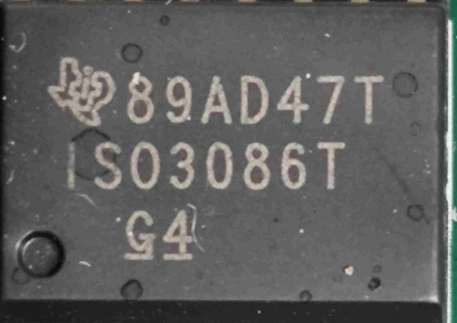

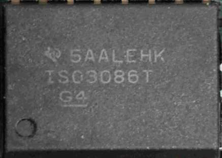

Hi team,
Our customer is using this device in a mass-production model, and we have confirmed the 4M change based on the PCN notification issued in 2023.
With this 4M change, we observed a reduction of approximately 5 mA in current consumption when comparing device 1 to device 2. However, for IC 3, which is from the same lot as 2, we have observed a phenomenon where the current consumption is approximately 15 mA lower than that of 2.
Questions:
  • Although ICs 2 and 3 have different markings, can you confirm whether they are indeed from the same lot?
    We are currently confirming the reel label information with the customer.
  • Is it possible to estimate the cause of the difference in current consumption based on package differences between 2 and 3?
  1. Pre-PCN device
2. Post-PCN device (approx. 5 mA lower current consumption than (1))
3. Post-PCN device (approx. 15 mA lower current consumption than (2))
Kyohei

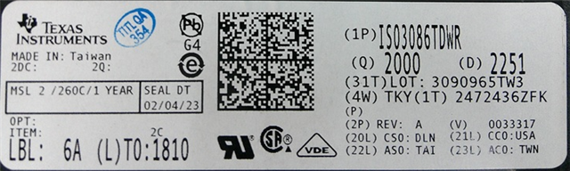

    We have additionally obtained the package label information, so please see the details below.
    In addition, we have received the customer's circuit diagram, and I would like to send it via private message.
    I have sent you a friend request, so I would appreciate it if you could accept it.
    Kyohei

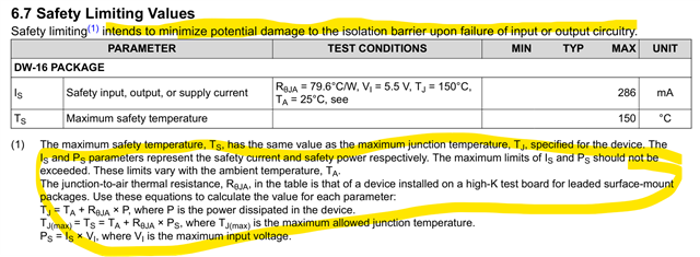

    How was the “Is” value in the figure below measured?
    Is my understanding correct that it represents the sum of the current consumption from Vcc1 and Vcc2?
    Kyohei

    On the Is question - Please note that this is not a measured value, rather a maximum total allowable current inside the device so that the internal power dissipation does not raise the junction temperature beyond 150C, which can potentially damage the Isolation barrier.
    Please refer the highlighted section for detailed explanation.

    I've just verified that IC 2 is a pre-PCN device and not a post-PCN device, which is why you don't see much different with respect to IC 1.
    Also, the package label information share above also indicates pre-PCN device.
    The post-PCN device is only IC 3 which shows 15mA of ICC1+ICC2 and is well under datasheet spec after PCN - Hence there is no issue here.

      1. Just so we're clear here - This label that you have shared above indicates pre-PCN material. IC(2) is a pre-PCN device and the PCN changes do not apply to IC(2).
