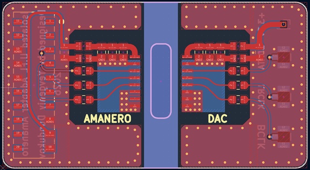

Based on the information provided, I designed my own I2S signal isolator. It receives 3.3V power and BCLK, LRCLK, and SDATA signals from a USB converter (such as an Amanero) and then transmits them— galvanically isolated—to the DAC inputs.
Schematic diagram
PCB Layout
PCB view
In terms of signal transmission, the device works. However, the output signal quality of the ISOW6441 is inferior to the input quality: high-frequency noise and interference from the BCLK signal (frequency range 2.8–12.2 MHz) are superimposed on the WCLK (44.1–192 kHz) and SDATA (frequency range similar to BCLK) signals. On an oscilloscope, this manifests as modulation of the top and bottom sections of the square wave: oscillations appear at the BCLK signal frequency, albeit with a lower amplitude.
Am I right in understanding that this is a manifestation of parasitic capacitive coupling? If so, it is unclear at what level this is occurring—inside the chip, at nearby components, or in the PCB layout —and how it can be eliminated.
 Thank you.
Regards, John D.

  • Hi Dundukov,
    Yes, I can see it now and have reviewed it.
    Both schematics and PCB Layout looks good - no issues spotted.
    However, I want to confirm one thing since the component designators are not visible - What is the sequence in which C5, C6 and C7 are placed on VISO-GND2? I ask this because I see the order reversed in schematics than what it should be ideally. Can you confirm?
    Also, do share the waveforms so that we can understand what is the nature of the noise and its amplitude that you're observing.
    Varun
  • What is the sequence in which C5, C6 and C7 are placed on VISO-GND2?
    In the following order: first 100 nF, then 1 µF, and finally 10 µF, counting outwards from the chip's output.

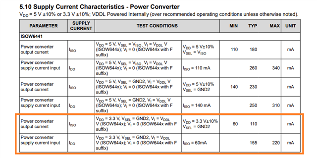

    I noticed that the specifications for the Amanero board (on the signal source side) limit the supply current to 50 mA.
    Is this sufficient for the operation of the ISOW6441?
    The supply current specifications in the ISOW6441 datasheet appear higher; I wonder if the chip is experiencing current starvation.

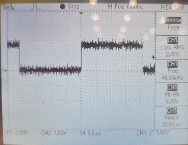

  • The output signal waveforms (for the LRCLK line) are shown below:
    At the same time, the BCLK line frequency was 3.072 MHz. I believe that this is the modulation frequency that is observed, taking into account the resolution of the oscilloscope.
    I also tested the hypothesis regarding the supply current, but it was not confirmed: when using a laboratory power supply instead of the Amanero board, the output signal waveform remained exactly the same. This also made it possible to measure the current consumed by the board—exactly 40 mA—which falls within the permissible limits for the original signal / power source.
  • So, I found the culprit. It turned out to be the ferrite beads in the input and output grounding circuits.
    In the current version of the board, I used Murata BLM18HE152SZ1D ferrite beads (1.5 kΩ @ 100 MHz, 0.5 Ω, 500 mA) - the same ones found on the ISOW6441DWEEVM board. However, they caused modulation of the power ground potential on both sides. I replaced them with jumpers, and all the issues disappeared. This problem was specific to the ferrite beads in the ground path (FB2, FB4); I left the beads in the VCC and VISO paths (FB1, FB3) in place.
    This hypothesis needs to be verified.
    IDD can be lower in your use case since you are not extracting all of 60mA load current (IISO) out of the VSIO pin. Hence, 50mA is currently enough for your application.

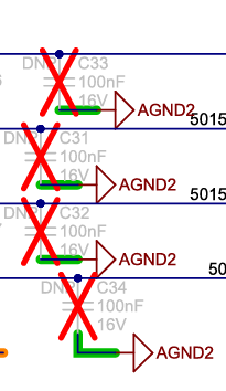

    Apart from removing FB from GND1 and GND2 - there's one more experiment that can be performed which can help in fixing this - this is an option on ISOW6441DWEEVM as well. The below DNP capacitors on GPIO can act as an RC Low pass filter and filter out the high frequency noise.

  • I connect the probe directly to the U.FL connector: the ground clip to the housing, and the center contact to the solder joint of the U.FL center pin.
    I think, the problem is ground return path interruption. The I2S signals (SDATA, LRCLK, BCLK) operating between the Amanero header, the digital isolator, and the DAC connectors are high-frequency digital signals with fast rise and fall times. High-speed signals require a continuous, low-impedance return path directly beneath or adjacent to the signal traces to minimize loop area. Ferrite beads are designed to introduce high impedance (up to 1.5 kOhm @ 100 MHz) to high-frequency AC signals. Because the ground reference is split by these ferrite beads, on the primary side, the return currents for the signals coming from J4 (AGND1) must pass through FB2 to reach U1's ground (GND1). On the isolated side, the return currents for the signals going to the DAC connectors (AGND2) must pass through FB4 to reach U1's isolated ground (GND2). Forcing high-frequency return currents through the high impedance of a ferrite bead creates a voltage drop across the bead. This results in ground bounce, which distorts the digital waveforms, increases jitter (highly undesirable for audio DACs), and can lead to data transmission errors.

  • Hi Dundukov,
    Yes, the return current path explanation might be a valid reason here.
    For now, you can go ahead with the design changes above if radiated emissions is not a concern for you. You can also just use a 0ohm resistor by replacing FB2/FB4 instead of redesigning the board, if that is too much trouble.
    We will also work internally to understand this better. Thanks for your interaction and experiments to bring this to our notice.
