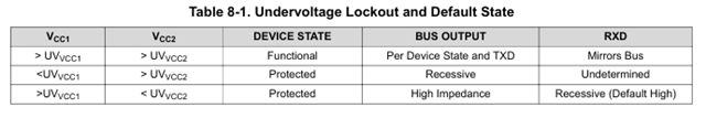

    When you say board Powered OFF - Do you mean powering OFF the VCC1 or VCC2 or both on the board?
    Also, can you double confirm that both CANH and CANL are 0V at the same time?
    This cannot be a device behavior at all in any of the Power Condition for VCC1 and VCC2 as ISO1044 cannot drive the CAN bus to 0V in any of the power OFF condition:
    If it indeed is 0V for both CANH and CANL, then you need to double check the boards on CAN side of all the boards that might be shorting to GND2 in powered off condition.
    Additionally, one comment form schematics that I observed - Please add an additional bulk capacitor on VCC2 (like 10uF) for optimal operation of device. This is mentioned in the datasheet as well in section 10.

    In our case, when both VCC1 and VCC2 are powered OFF for any one of the boards in the CAN network, will it impact the CAN bus communication for the entire network?
    We expect the CANH and CANL pins of the powered-off board to go into a high-impedance state so that the board does not affect the bus communication. Can you please confirm if the transceiver will behave this way in the power-off condition?
  • Hi Mallikarjun,
    Yes, that is correct.
    When both VCC1 and VCC2 are OFF, the CANH/CANL will be in Hi-Z state (High Impedance) - which means that it will not affect the bus communication.
