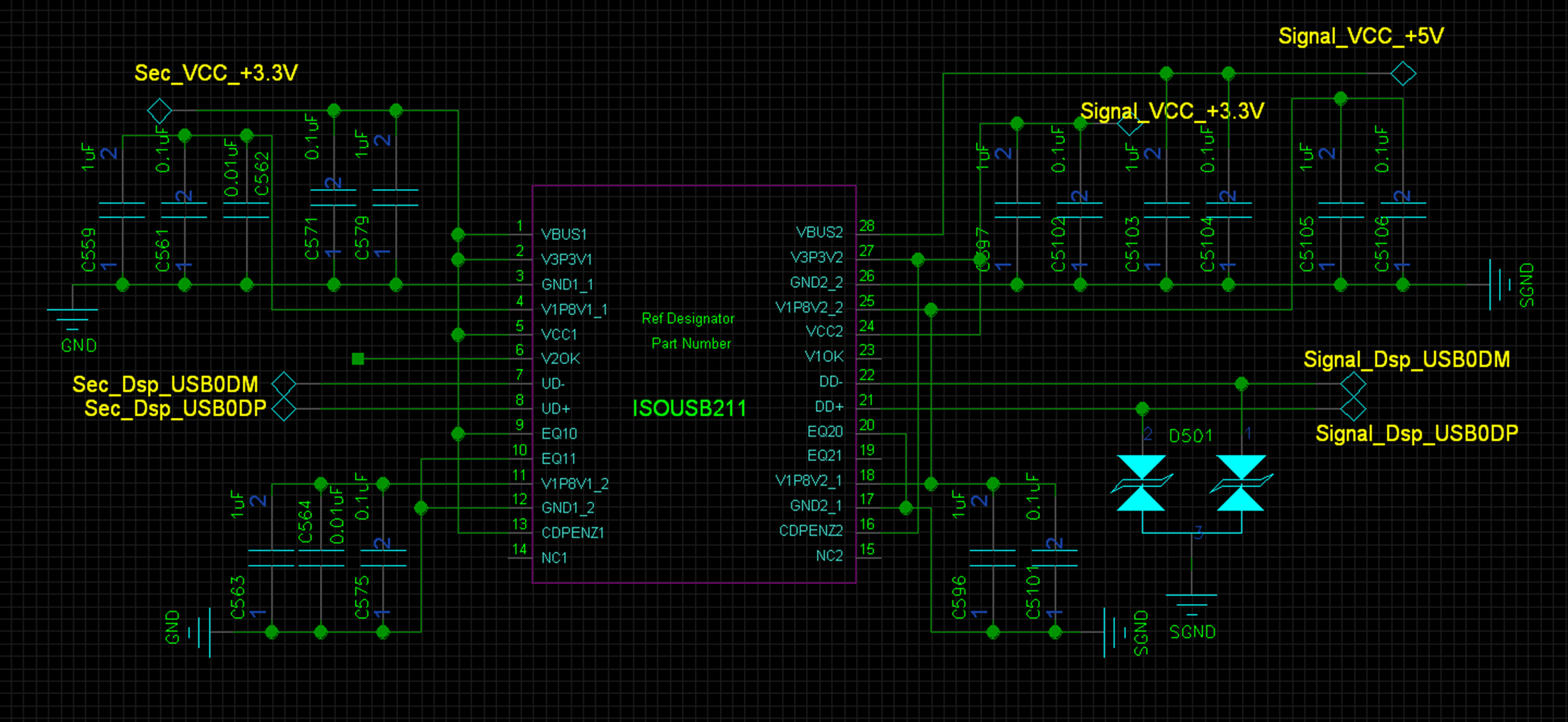

Hi Team,
Could you please help review below schematic? Thanks. Besides the lack of VBUS TVS, any other issues?
BRs,
Francis
  • Hi Francis,
    Schematic overall looks good but following comments need to be incorporated:
    1. Replace all 1uF capacitors at all V1P8Vx pins with 2uF as mentioned in the datasheet.
    2. Is EQ21 pin left floating intentionally? - if not the connect that to GND2 as well just like EQ20
    3. 0.01uF Capacitor is missing from Pin18 and Pin25. Please add these just like done on Side1.
    Varun
