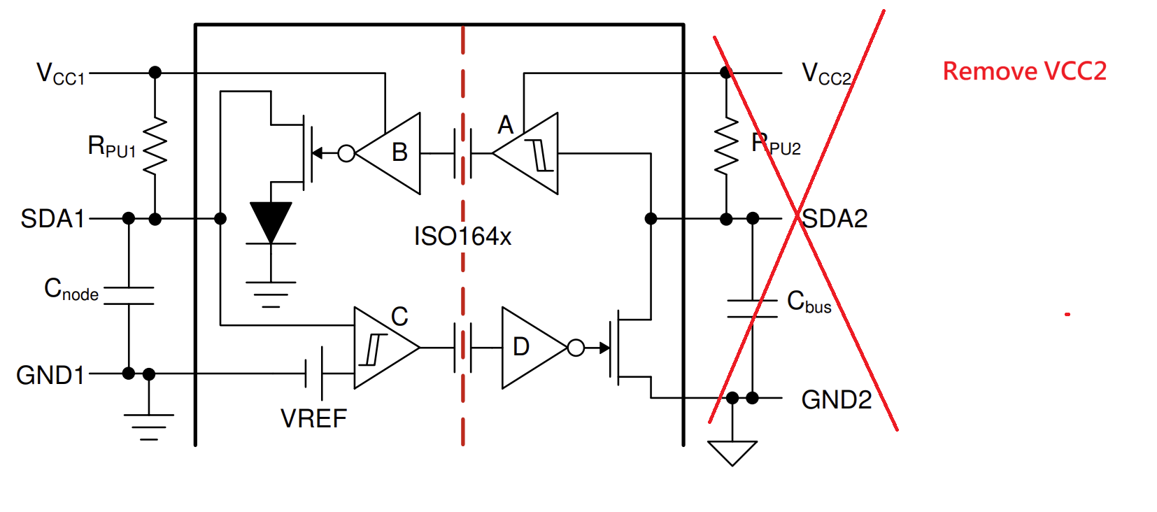

Hello Expert:
 We have an urgent case need to estimate the max current consumption of ISO1640 product as below . can you please help provide the max current consumption of VCC1?
Condition:  Revmove VCC2 / SDA2/SCL2 all power and signal side , what's the max current consumptoin on VCC1 ?( ICC1 max) = ?mA
  • Hi Roy,
    The ICC1(max) is already specified in the datasheet under "6.10 Supply Current Characteristics".
    The maximum ICC1 (VCC1 supply current) when the secondary side (VCC2, SDA2, SCL2) is removed/unpowered depends on the VCC1 operating voltage:
    VCC1 Range ICC1 Typical ICC1 Max Test Condition
    3 V ≤ VCC1 ≤ 3.6 V 5.2 mA 7.1 mA VSDA2, VSCL2 = GND2
    4.5 V ≤ VCC1 ≤ 5.5 V 5.3 mA 7.2 mA VSDA2, VSCL2 = GND2
    These values are from the worst-case condition where VSDA1, VSCL1 = GND1 and VSDA2, VSCL2 = GND2 (dominant bus state), with pull-up resistors and capacitors open.
