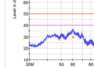

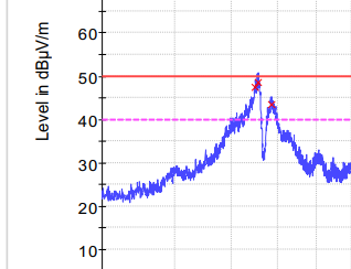

I have tested my equipment based on  ISOW7742FDFMR by IEC 60601-1-2 (class A emissions). The test results showed a very narrow margin from the limits in the 50 to 60 MHz range (graph below, limits for 3m distance from the antenna, horizontal polarization - vertical is not relevant for this discussion).
My equipment is connected to another via an isolated RS-232 port, with the ISOW7742 and a  MAX3232ECPW level converter.
We requested the test lab to add snap-on ferrites (nominal impedance of 170 Ohms at 100 MHz, 75 at 25 MHz) close to the DB-9 connectors. That resulted in:
The quasi-peak mark is 20 dBuV/m below the limit.

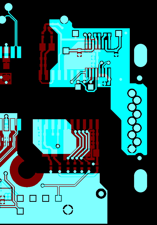

For reference, this is the board at the region of interest:
 I found with the near field probes that there are spread-spectrum components when the probe is placed near the ISOW7742 (obviously) but also in the DB-9 connector vicinity. I believe this magnetic field induces common mode conducted currents that travel along the serial cable that becomes an antenna. Adding the ferrites suppresses these currents.
 I tried my best to follow the guidelines of the SLLA561 document, despite the limitations imposed by the geometry and PCB real state of my board.

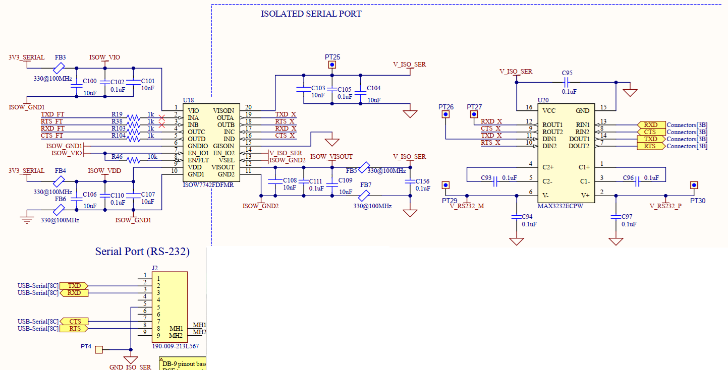

Below are the relevant parts of the schematic.

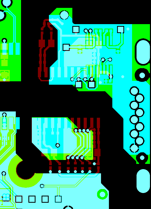

Below, the top and bottom layers and down below, I added one of the inner layers (all the four inner layers follow similar geometries). I may send the gerber files and schematics by email, if necessary.
Is there a way to solve this issue at the PCB?
