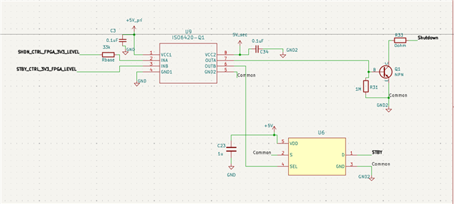

    Is this correct way of operating switches BJT as switch in open collector configuration and analog switch present is TMUX1101 or I need to do something there? And in secondary side I have 24V Is there any part which is avaialble in secondary side can be Vcc2 of 24V or greater ?

    • Is there one single part can be good or resolve the isolation issue for both analog switch and BjT as switch . If one part is not applicable for both application as switch . please provide correct reason and explanation for that . Means 2 channels device can't be used for both requirement.switch is having VCC of 5V and current of drain to source is approximately in 24-25 mA. And for BJT Open collector configuration is there. So That collector voltage is internally in the electronics circuit we need to drive bjt using base current which is max 1mA but current calculation seems in micro-ampere. FPGA commands given 3V3 level and 0V to turn on and turn off  bjt as switch to operate in Saturation and cutoff state. And analog switch tmux1101 is used. Can you please tell in schematic it is correctly done by using digital isolator that Vcc and gnd and sel pin and drain to source that is connected to load is correctly done to separate FPGA ground to the load ground in standby operation. As TMUX1101 is TI part you can refer that . If I am missing something.

  • Analog switch input is also given by FPGA with 3V3 level and 0V to operate switch on and off operation
  • NIshant,
    For operating SEL pin of TMUX, Digital Isolator (ISO6420) is sufficient as it is a digital output (OUTB) to digital Input (SEL) operation.
    But for BJT, since it is a current controlled device, the OUTx pins cannot be assumed to drive the base of BJT. For VCC2=5V, the max current that OUTx pin can deliver is 4mA.
    If the BJT's base requires >4mA, the ISO6420 is not a suitable option. If it is <4mA, then you can go ahead with the ISO6420 in the schematic above.

  • Then for BJT which is option you suggest best
  • The most common advice that I can provide is to connect a series base resistor, Rb, between OUTx and the base terminal.
    It limits the base current to a safe level for both the driver and the transistor. Calculate Rb using the required saturation collector current Ic, choosing a forced beta/hfe of 10 to 20 to ensure hard saturation
