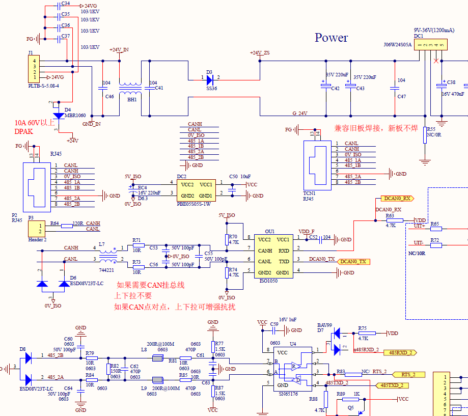

Using ISO1050, there are 107 boards with 7 defects. Can you help me check if there are any design issues?
The schematic diagram is as follows:
  • Hi Team,
    This project has produced products before and no issues were found. We found this issue with the latest batch of ISO1050 products.
  • Reed,
    Your schematic doesn't show any reason to cause damage or issues in an application, though I will say that R70 and R74 are unnecessary for proper CAN communicaion.
    Can you give more details on the issues you are seeing on the 7 defects? That will help narrow down where the issue may be rooted.
