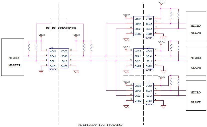

Hi.
I want to build a multidrop i2c isolated bus using ISO1541.
I have a micro master  and 8 micro slave.
I need to do a Read/Write operation.
Is the schematic in attached correct ?
What about speed if the maximum distance is  1 meter ?
Thanks.
Mario.

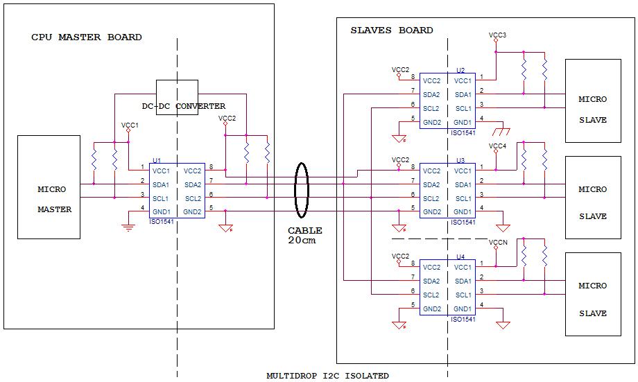

  • Thank you Rao.
    I still haven't chosen the value resistor.Before i wanted to know if the schematic (new) is correct.
    Vcc1=3.3V Vcc2=5V Vcc3=5V.  2.2K on Vcc2 side can be ok ?
    Maybe the problem could be the cable (20cm) between the board master and the board slave (8 circuit in the same board).
    However i can lower the speed... (about 38400).
    Regards.
    Mario.

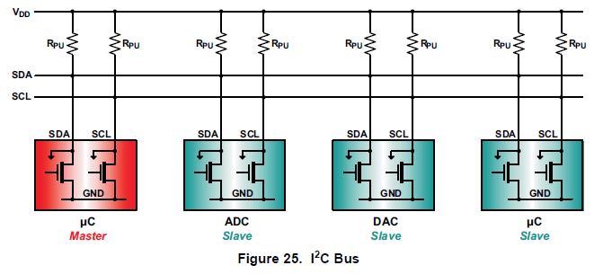

  • Hi Mario,
    You will need to add pull-up resistors on side 2 of slaves as well, as shown in Figure 25 of datasheet. Otherwise everything else looks fine.
    Koteshwar Rao
