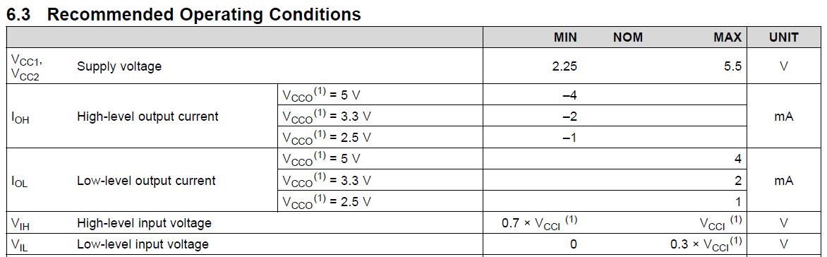

  • Hello Julien,
    I am attaching a snapshot of ISO78xx datasheet that lists input logic level requirements of the device ISO78xx. Based on VCCI applied, min Input High Voltage (VIH) should be at least 0.7*VCCI & should not exceed VCCI. Max Input Low Voltage should be at most 0.3*VCCI & shouldn't go below 0V.
    In your case, car controller output is either floating or GND hence you could use a pull-up resistor of 4.7kΩ from car controlling output pin to VCCI (2.25V to 5.5V) which will make the pin be either HIGH or LOW. This should be a valid input for ISO78xx family of devices.
    There will be similar requirement for ISO73xx family that should be mentioned in the datasheet.
