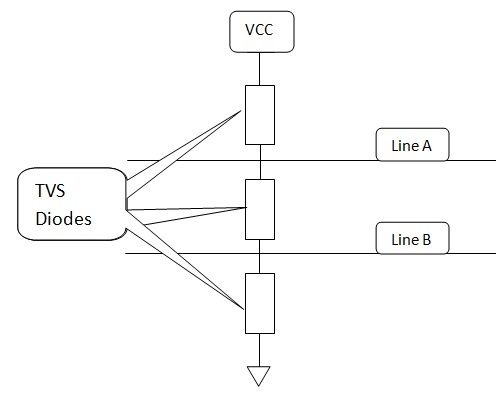

1. Transient Protection:
We are using TVS dides as shown in the attached image.
However, we are not using TBU or GDT in our design.

    1. For most applications TVS suffices the need, TBU & GDT are generally required for much higher power handling.

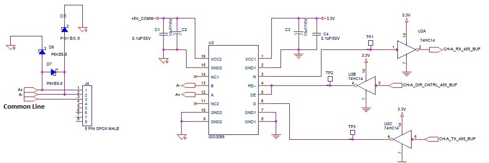

    I have added RS485 section schematic.
    As of now we are using only the TVS diodes for protection.
    The unit is housed in metallic IP68 casing in open environment.
    These units are installed in very harsh conditions like thermal power plant, oil rigs and oil loading and unloading terminals (not petrol stations).
    Our design team is discussing whether to continue with the ISO3088 or switch to the other makes like ADM2485 or LTM2881.

  • Hi Shirvardhan,
    Schematic looks fine.
    Can you please elaborate on the requirements?

  • Hello Shivardhan,
    I just had one comment, the TVS diodes indicated in the schematic look to be unidirectional. I see they are connected in the opposite direction which could pull RS-485 Bus pins to LOW all the time. Or are they bidirectional? Could you please confirm?
