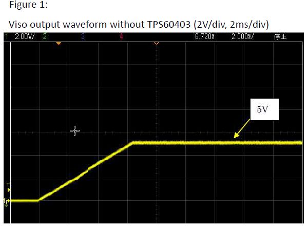

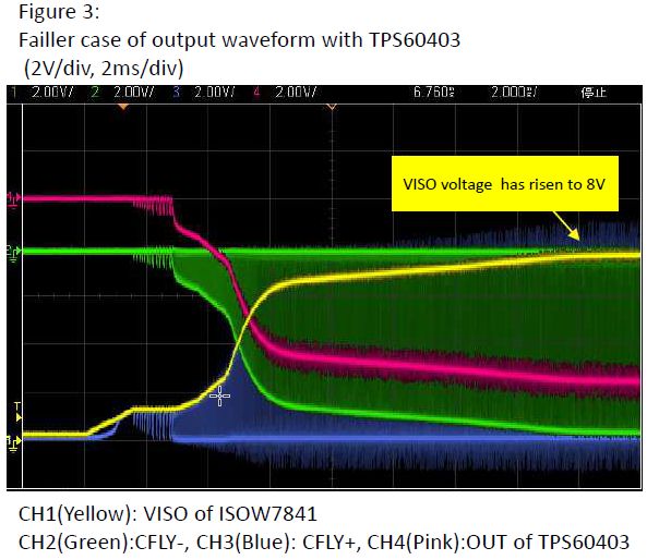

Hi, all
My customer is facing the following problem.
 When the power is on, the ISOE7841 output voltage of Viso is 5 V in normal state, but in case of abnormality it rises to 8 V with a probability of about once every tens of times.
As a result, TPS 60403 will be broken.
The customer suspected the noise from TPS 60403 and tried putting FB after Viso, but it did not improve.
Would you give me any advice on how to solve it?

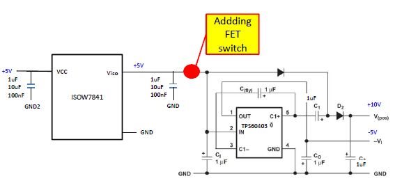

  • Hi Toshi,
    This behavior is not expected from the device. Could you please clarify a few points that can help us with this debug?
    1) I am not able to see any decoupling caps on the VISO pin. Could you please confirm that there is sufficient decoupling capacitor on the VISO pin? Recommended value is 0.1uF + 1uF + 10uF. If sufficient decoupling cap is not present on VISO, the device may not function properly.
    2) Could you please explain a bit more on the type of failure seen on ISOW7841 device. I understand the voltage goes upto 8V. Is the ISOW7841 device damaged after this happens or does the device resume normal operation (returns to 5V) once it is power cycled?
    Anand Reghunathan
  • Hi Anand-san, thanks for your quick response.
    Below is the answer for your questions.
    1) There are decoupling capacitors ( 0.1uF + 1uF + 10uF) on VISO pin. I am sorry I forgot to draw these.
    2) Only the TPS60403 was damaged. And the voltage of VISO is dropped to about 1.5V. It seems that the internal circuit of TPS60403 is shorted.
    After replacing TPS60403 with new one, ISOW7841 can operate normally.

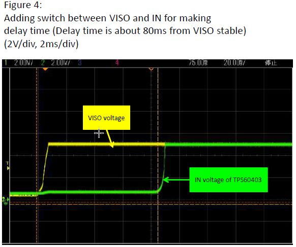

  • Hi all,
    I would like to update the test results as follows.
    Customer tried to add the FET switch between VISO pin and IN pin for making some delay time.
    And they conducted 5000 power-on tests using eight prototypes and as a result, no problem occurred at all.
    Why is this method effective?
    Why does the voltage of VISO rise to 8V if it is the original method?
    Is the control of the ISO7841 DC/DC converter open loop or closed loop?
    When the ISOW7841 is in the transient state of SOFT START, is there a possibility of malfunction of overvoltage when the load with the charge current of TPS60403 is the load?
    Is there a possibility that VISO will exceed VISO_max when VCC is around 2V?
    Is there overvoltage protection in the output of VISO of ISO 7841?
    Toshi
