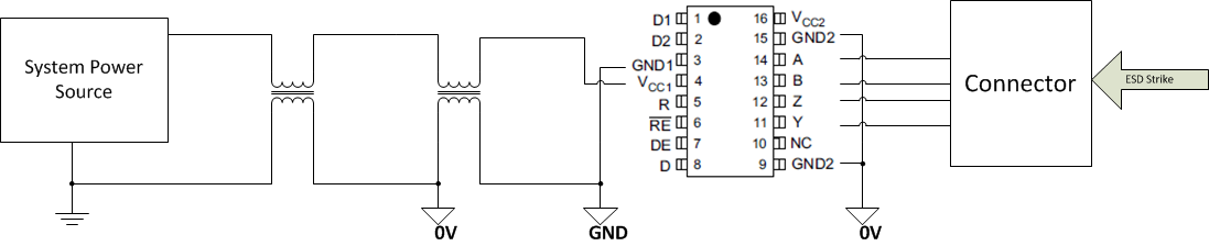

I was interested in using this part on a current design, but I'm concerned by the following excerpt from the datasheet:
"TI recommends not testing equipment transient susceptibility with ESD generators or consider product claims of
ESD ratings above the barrier transient ratings of an isolated interface. ESD is best managed through recessing
or covering connector pins in a conductive connector shell and installer training."
I am confused by this statement given the ESD claims of +/-11kV in the datasheet.
Would it be possible to confirm if this part meets the following:
- EN 61000-4 level 3 air discharge (+/-8kV)
- EN 61000-4 level 2 contact discharge (+/-4kV)
