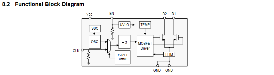

    Alternatively, the SN6505 has a clock input - Is that internal circuity latch-up proof? How does internal oscillator and external clock interact with each other? This is not exactly clear to me what happens when external clock is not valid anymore, etc. and the associated impact on the internal oscillator.

    When using an external clock, circuitry inside the SN6505 detects the clock signal and multiplexes it to the rest of the circuit instead of the internal spread-spectrum-clock, as shown in the datasheet clipping below:
    If the external clock reaches an invalid operation, the internal circuitry detects this, and the SN6505 resumes operation using the internal clock.
    The SN6505 is a robust device that has multiple self-preservation features. In the case where one of the transformer driver pins, D1 or D2, are shorted, the device would limit the current it consumes with internal current-limiting, and if the temperature rises due to the short condition, the device would power off with an internal thermal shutdown feature. Both of these operate on a cycle-by-cycle basis, so if the temperature or current return to normal, the SN6505 could return to normal operation.
