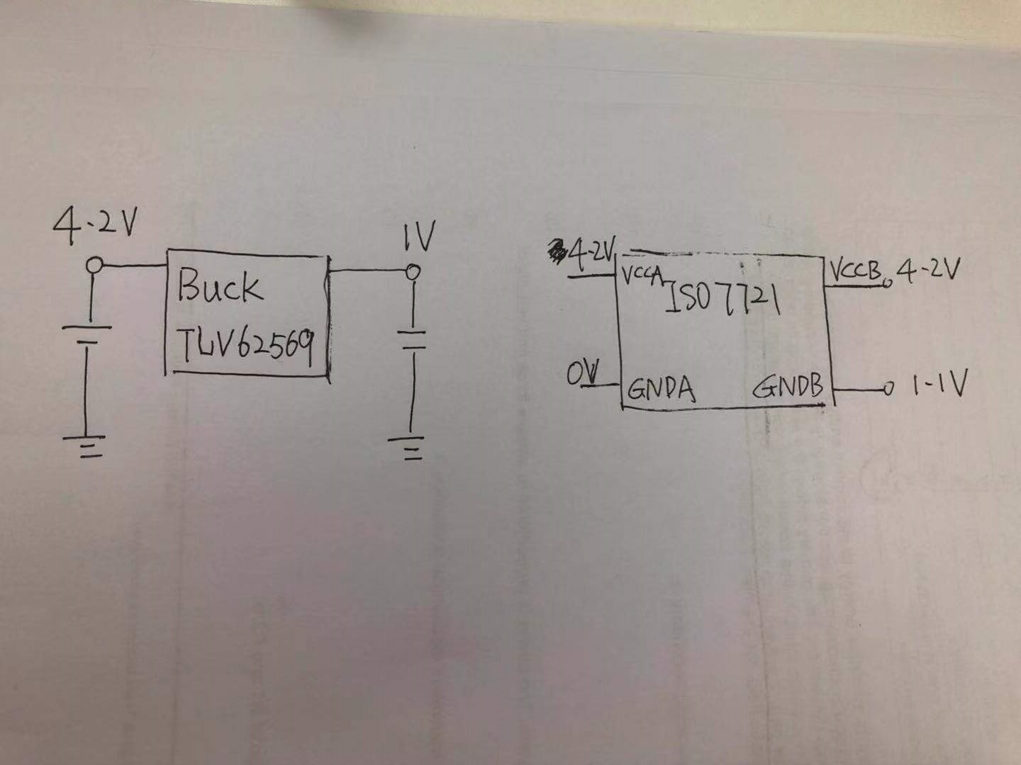

My customer has a new requirement I listed below:
3.3V(High)-0V(Low)input to 3.3V(High)-1V(Low) Output. 10Mbps data rate.
I have an idea to achieve this requirement with our ISO7720 and need to double confirm with you.
Below is my question:
- Could we supply the device with 3.3V to VCC2 and 1V to GND2 to achieve this? (3.3V and 0V is applied to VCC1)
- If it could will it output a low level with 1V in output?
- Could we generate the 1V from VCC1 to power GND2? (Customer didn't need isolation actually)
