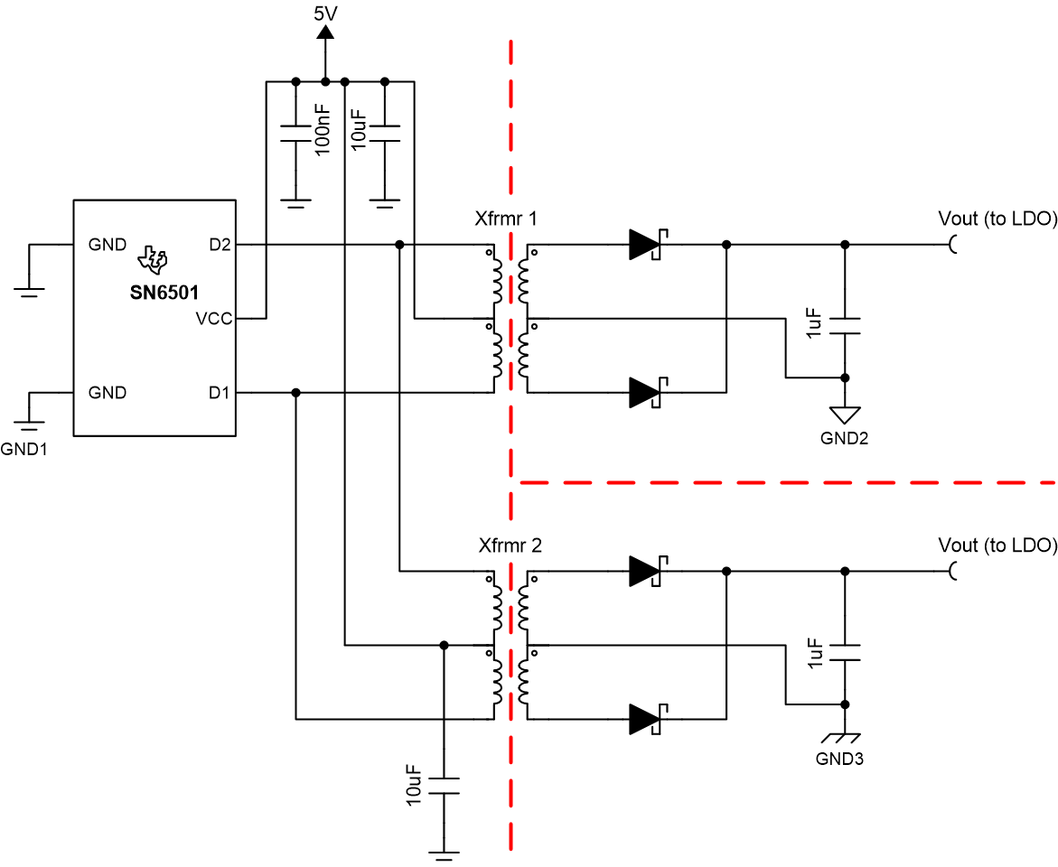

Can I get a DC-DC converter designed with SN 6501 for the following:
INPUT:5VDC
OUTPUT1:15V,50ma
OUTPUT2:15V,50ma.
If possible,can I get:
The core details
The number of primary &secondary turns along with the copper wire gauge details.
VTC
9980522856
Hi VTC,
Thank you for posting to E2E!
SN6501 can only drive up to 1.75W of power across an isolation transformer. For this dual-output case, please use SN6505B. TI does not specify the transformer windings or wire gauge, but two transformers like Würth's 750316813 and 750316818 can be driven in parallel as shown in the topology below:
