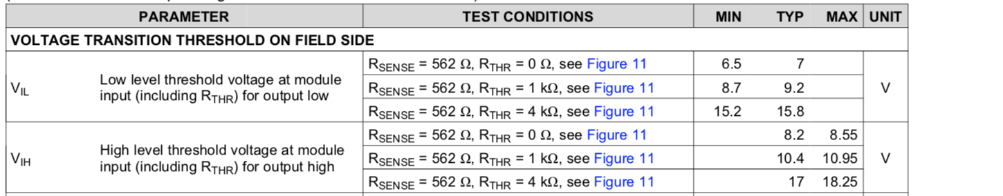

  • Hi Koteshwar,
    Thanks a lot for the response.
    1. The situation we discuss is Vin <60V.
    2. For fault condition 1, the device will continue to function normal. Does that mean the VIH is 8.25V and VIL is 7.1V based on equation 2, 3. Is it correct?
    In this condition, ISO1212 cannot recognize Rthr is fault, right?

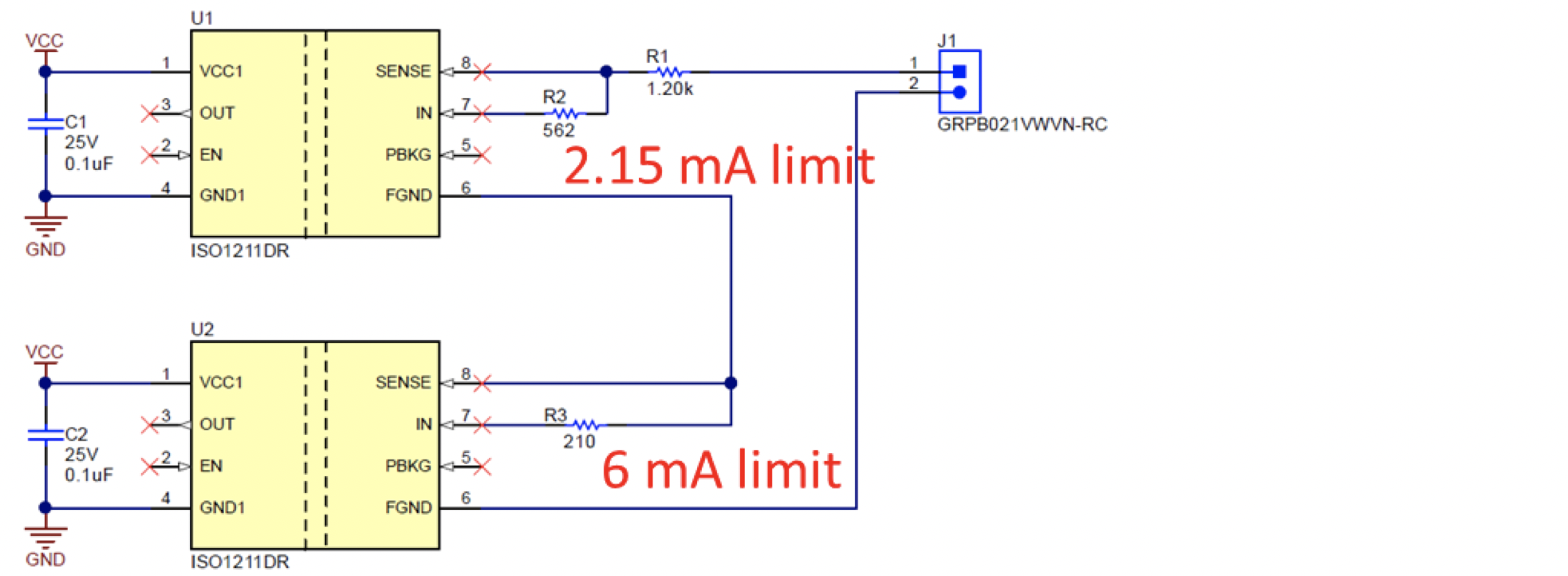

    3. Due to this case is for functional safety application, do we have more suitable solution that is under development can be introduced to customer?
    I meant to say that the device will not be damaged and is going to work the way it is expected to. But since RTHR is shorted, the VIL and VIH thresholds are going to change. The updated thresholds will be similar to the conditions with RTHR = 0, as given in the datasheet and also copied below.

    Rthr is good, Rsense is shorted :
    Since RSENSE is shorted here, the current will no longer will be regulated by device and is only limited by RTHR. Assuming RTHR = 1kΩ, the current into device will depend on the applied input voltage. i.e., it will be about 24mA for 24V inputs. Continuous operation with these conditions could lead to device reliability.
    Vincent Chen64988 said:
    Both Rthr and Rsense are shorted :
    This is similar to earlier case that current will not be regulated by ISO1211 and since RTHR is also 0Ω now, the current into device is also not limited by any resistor. Based on voltage applied, this can lead to a large input current and eventual device damage.
    To address this challenge for functional safety application, customer can follow the below approach where two ISO1211 devices are used in series. Instead of two ISO1211 devices, you can also use on ISO1212 where the two channels can be connected in series. The second channel / device acts as a fault indicator which under normal operating conditions output LOW output. But when there is RTHR and RSENSE short of first channel / device then the output of second channel / device goes HIGH indicating a fault. Since the second device is limiting the current to 6mA, neither of the device will be damaged.
    Let me know if you have any questions, thanks.
