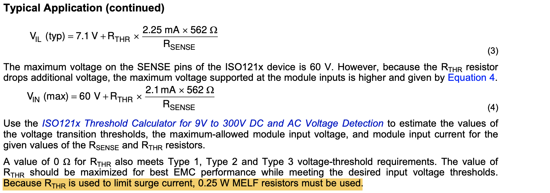

We found that the Rthr you used for ISO1212 EVM is 0.25W and is AEC-Q200 Grade 1.
Why you need to use 0.25W resistor in this case?
Is there any calculation to let us know the power dissipation of Rthr?
Thank you.
