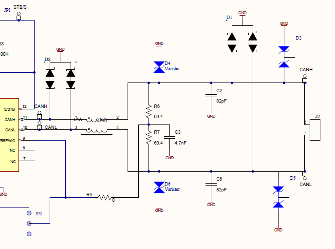

    For the most part the only other design considerations that need to be considered are the type of external protection that you want to provide on the CAN bus pins. These protection schemes can vary from OEM to OEM. Below is a picture of a genaric CAN EVM that we have that enables uses to choose between have chokes, diodes, caps in different areas on the bus.

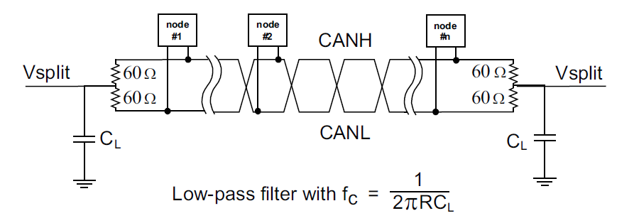

    As for split, what are the advantages?

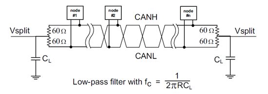

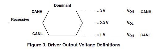

    The split pin offers some bus stabilization. The combination of the output 2.5 volt supply,  and the resistors and cap which make a low pass network, will help remove high frequency noise on the bus.

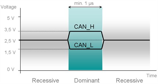

    What I do not understand it "the CAN bus voltages are +9V (low) and +16V levels are generated". A CAN bus has the following characteristics:
    Our tranceivers are designed to hold the bus recessive at 2.5 volts and have the dominant state create a ~2volt differential signal centered around 2.5volts. Please provide me more information on the CAN bus for your Deisel Truck application and I can be of more assistance.
    John

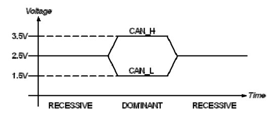

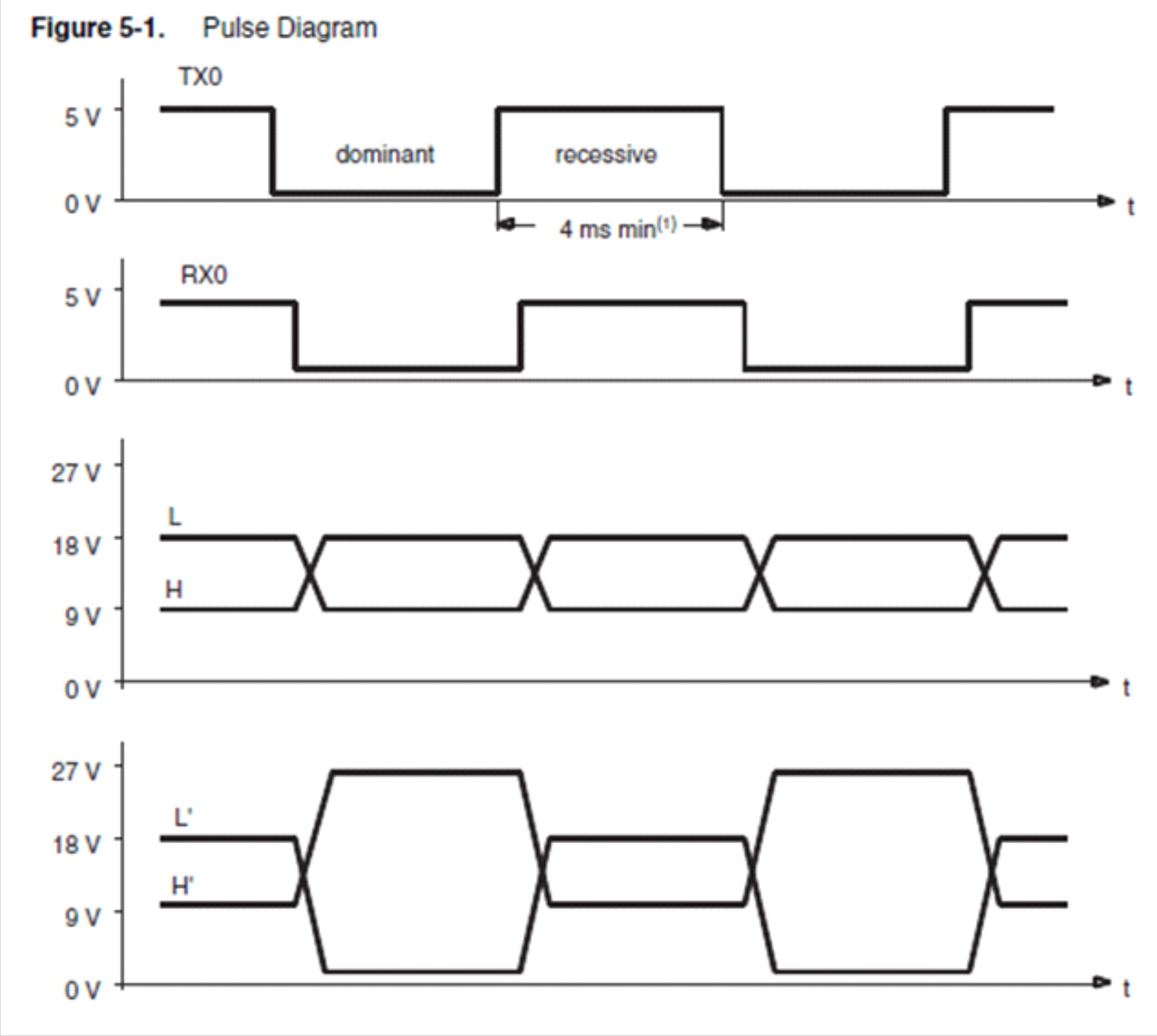

    Now, as for voltage levels: Indeed the physical reality of the CAN busses I've come across in heavy duty vehicles has quite different voltage levels than those you mentioned, most likely to withstand electrically harsh environments. The actual waveforms are something like this:
  • For some reason the waveform pic did not get posted. Here it is:
    Apparently this is according to ISO WD11992-1.
    All real life readings I've come across are +9/+16V.
    Cheers
    Daniel

    This is the first time that I have seen CAN bus voltages at these levels. TI does not offer any devices capable of this. We have some 3.3 volt and 5.0 volt CAN transceivers.
    3.3 volt bus levels:

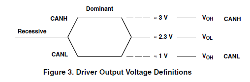

    5.0 volts bus levels
    John
