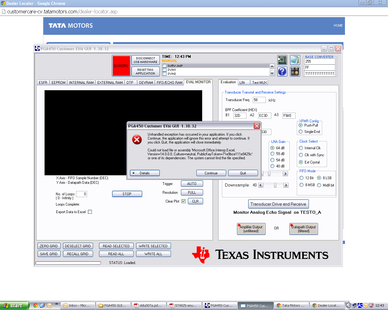

After that in ESFR window we click the OFF(MicroReset) and Press READ ALL button. Here we are getting some hex value in the table, then we press the ON(MicroActive) button and go to DEVRAM. Now, we Load the .hex file through DEVRAM (only "program DEVRAM through hex file and verify DEVRAM programming" check boxes are selected). The Error shown is DEVRAM Verification Unsuccessful. After that when I go to the EVAL MONITOR and set all the Evaluation parameters and Press "Transducers Drive and Receive" and then Press START button , we are getting a ERROR message as shown in the picture below :

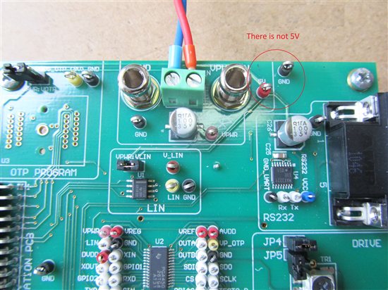

Also we have seen that the 5 V is not available at test points. For more information please see the below image:

    For the evaluation tab error, do you have Office 2007 or Office 2010 i1050.PGA450 GUI 1.38.33.zipnstalled on your computer?  The GUI version you are using has a problem with Office 2007.  I've attached the corrected GUI.
    The 5V is generated from the TI-GER board, and is only needed for UART communication over RS232.  Is the jumper on the TI-GER board on 5V?  There might be an extra step you have to follow on the GUI to turn on the 5V, but I won't be able to check until next week.

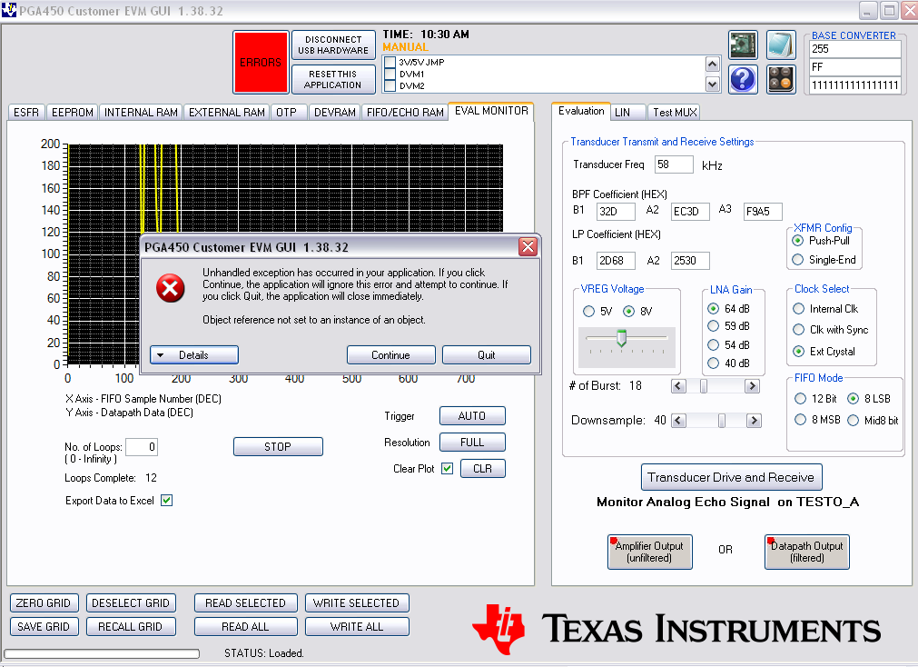

  • Dear Clancy Soehen,
    Thanks for your valuable support.
    Now the GUI is working fine but we are facing problem in Export Data to Excel. When we click the  “Export Data to Excel” check box then we are getting Error as shown in below Screen shot:
