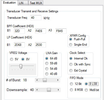

    If you have the PGA450EVM, you don't need to program the PGA450 to use the evaluation tab.  You just need the right settings.  The attached picture shows settings you can start with for a 40kHz transducer.
    You can write to registers using SPI to configure and start a distance measurement; however, you'll need to program an algorithm into the 8051uC inside the PGA450 to detect where an object is located.  Before worrying about that, you can observe what the echo signal looks like by reading and plotting the FIFO RAM.  That's what the "eval monitor" tab in the GUI does, but you can also export the data to excel and look at it that way.
