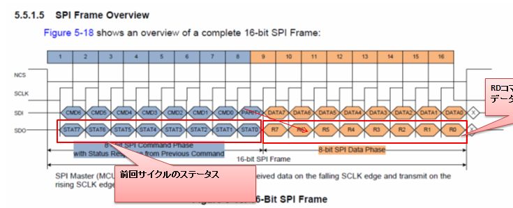

According to the datasheet explanation LBIST_ERR and ABIST_UVOV_ERR bits are cleared after SPI read access.
Please advise if these bits are cleared when SPI read error is occurred while read SAFETY_STAT_3 register and should perform BIST again.

  • Are you referring that SPI error during SAFETY_STAT_3 register read access may not clear status bits because valid SPI read command was not detected. If this is the case, then repeat the same read command again (SAFETY_STAT_3 read command)

    According to your answer, LBIST_ERR and ABIST_UVOV_ERR are not cleared when SPI read error is occurred.
    Please answer additional following question.
    Q1:
    SFETY_STAT_4 register has SPI_ERR bits. I think BIST error bits are not cleared in case of 01:Command error and 10:Format error, but I have question about 11:Data output mismatch.
    Does 11:Data output mismatch detects TPS65381 internal output data and SDO terminal data is different ?
     And Please confirm BIST error bits are not cleared in case of 11:Data output mismatch also.
    Q2: How to monitor SPI error.
    Device Status Flag Byte Response has following SPI status bit.
    STAT[2]: SPI SDO error (during previous SPI frame)
    STAT[1]: Data-phase parity (during previous SPI frame)
    STAT[0]: Invalid SPI transfer
    Please advise if SPI error can be monitored only using these 3 bits or need to monitor SPI_ERR bits of SFETY_STAT_4 register.
    Please advise if BIST error bits are not cleared when one of these bit is “1”.
    Best Regards.

     Q1: SFETY_STAT_4 register has SPI_ERR bits. I think BIST error bits are not cleared in case of 01:Command error and 10:Format error, but I have question    about 11:Data output mismatch. Does 11:Data output mismatch detects TPS65381 internal output data and SDO terminal data is different ?
     [Answer] Yes, data mismatch between internal SDO driver and SDO pin state.
     [Answer] BIST error bits have nothing to do with Data Output Mismatch (or SDO driver/SDO pin mismatch)
     Q2: How to monitor SPI error. Device Status Flag Byte Response has following SPI status bit.
     [Answer] That is fine. After confirming that one of STAT[x] bits is set and MCU can read additional status registers, but not mandatory.
    [Answer] BIST error has nothing to do with SPI Status bits that are communicated with each SPI response to received SPI command.

  • Q1)     Please confirm that BIST error bits are not cleared when 11:Data output mismatch SPI error occurred.
    A1)  If dataoutput mismatch occurs during a valid SPI read command to the BIST status register, these error bits will be cleared.  If data output mismatch occured during a valid SPI read command to non BIST status registers these error bits will not be cleared. If data output mismatch occured during invalid SPI read command these error bits are not cleared.
    Q2)     Please confirm that BIST error bits are not cleared when one of following Device Status Flag Byte bit is “1”( SPI error occurred).
     A2)  If the previous command was a SPI read command to BIST status register, no status bits are cleared.  If the previous command was some other SPI command it will not have an impact to the status register.
    Status of the previous SPI command has no impact on any following SPI command.
