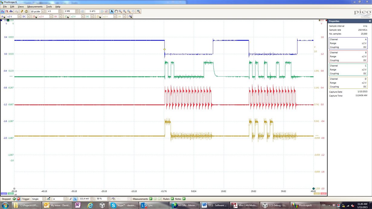

    I have some more data, and I have outlined it below with some scope screen shots.
    A quick recap:
    - I have the TPS65381 on an spi bus that is also used by an IO expander chip using the TMS570LS0332.
    - The IO expander chip seems to work when it is on its own.  So does the TPS chip.  But when I have both of them run, I see an error.
    - I am using the spi in the polling mode (using spi 2).
    - The program flow  is:
    -- initialize the TPS chip through the TI driver and set it to stay in the diagnostic state
    -- initialize the IO expander chip (set some registers)
    -- Create two tasks, one for the TPS watchdog, one to blink an LED connected to the IO expander once a second.
    -- Once the TPS watchdog task is called, the first thing I do is check that the TPS chip is in the diagnostic state by calling TPS_GetCurrentTPSDeviceState from the TPS driver. This is in a while loop until it returns that it is in the diagnostic state (0x7)
    So, what I am seeing is that the first time it is called, I get an error on the spi transmission.  The second loop through it is OK.
    The function TPSGetCurrentTPSDeviceState makes two transmissions to the TPS chip.  The first is to query the device state, the second reads the Safety Stat 4 register.  This read shows an error.  You can see this in the first picture below
    Blue trace - this is the chip select for the IO expander chip.  I put a probe on this to make sure it wasn't going active during the transfer, and it isn't, it remains high.
    Green trace - data from the Hercules to the TPS chip
    Red trace - clock
    Yellow trace - data from the TPS chip to the Hercules
    The screen shot below is stepping over the function the second time, everything is OK in it.
    Finally, here is a screen shot if I don't do anything related to the IO expander chip, and only communicate with the TPS chip, I only call the function to read the dev state once here.
    I don't know why it thinks there is error in the transmission..it looks ok to me..do you see anything that doesn't look right?
    Thanks for your help,
    David

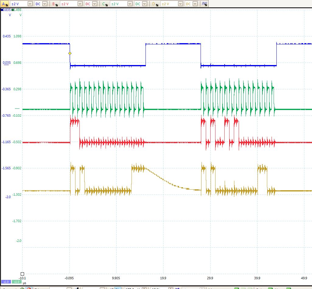

    I had the pull down resistor added, with no change in the behavior.  I stepped through the TI TPS library and verified that the Hercules is correctly reading the data (0xA007) from the SPI bus.  I also verified that the TPS chip select is OK, and that the two chip selects aren't active at the same time.
    David

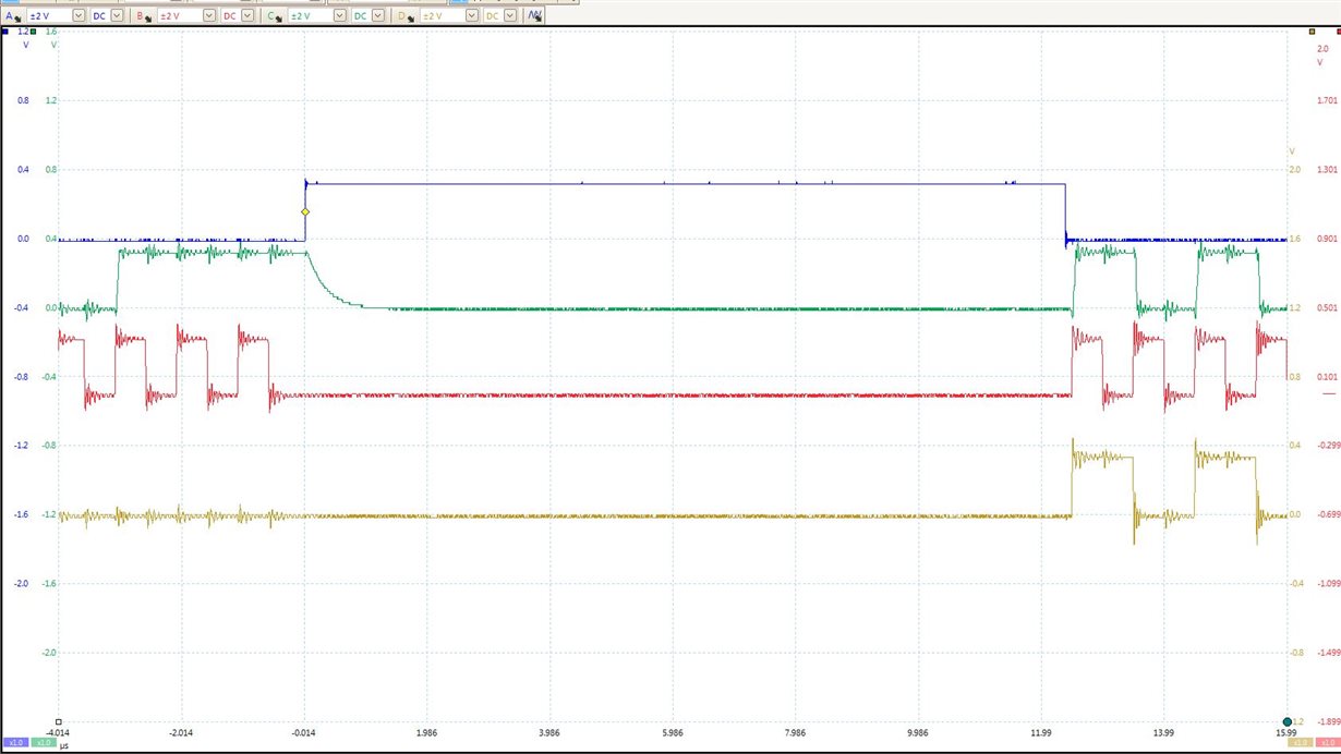

  • Hi Scott,
    Thanks for getting the test set up and checking.
    You are correct on the colors of the traces. I am travelling today, but should be able to get you a scope shot zoomed in on that to get a better look on Monday.
    Previously there was a pull up on the line, so after the response (0xA007) the line remained high and we were seeing the error, so that may make sense if the internal circuitry is expecting the line to be low but because of the slow fall time it reads high.
    The piece I don't understand is that if I don't communicate with the other chip on the spi bus, the trace looks the same but I don't see the SDO error.  Also, if I do back to back calls to the lib function to get the device state, the first pair shows an SDO error, but the second does not.  I will triple check this on Monday and see if I can get a nice capture on the scope.
    David
  • Below are a couple more scope shots (with a 10K pull down).  I'm back in IL now, so getting that swapped out is more difficult, but I'll see what I can do.
    The traces should be the same colors as before ( blue=nCS, Green = SDO, Red = SCLK, Yellow = SDI)
    This is a close up of the end of the first transfer (a read of the device state register).  In case you can't read it, the time base is 2 us / div.
    I also took a shot that includes 4 transfers.  When the TI lib does a transfer, it also does a second transfer to read the safety stat 4 register.  So the shot below shows a read of the safety stat 5 register and the safety stat 4 register, then that sequence again.  You can see that the second time the two registers are read it does not show the SDO error, but the traces look the same in terms of timing and the fall time from the read to the safety stat 5 register.  I can get a closer shot of any part of the signal if it would help, I know this one is pretty far away but I wanted to include all of the transfers. Time base here is 20 us / div
    [EDIT] As I have been stepping through the TI lib and doing more analysis, I noticed that on the second transfer ( a read of safety stat 4) It is returning a value of 0x4C.  Which indicates
    Bit 2 - WD ERR - It doesn't surprise me that the wdog fail count is 7
    Bit 3 - MCU ERR - Not sure what is causing this or if it is an issue
    Bit[7:6] - Command Error - This concerns me.  I don't know what exactly a command error is, or if it is an artifact / related to the SDO error.
    David

  • I thought it may be worth adding the following scope shot.  We have a second board (that uses the TMS570LS0332 as well) but this board does not have anything on the spi other than the TPS chip.  It is on SPI 2 as well, and all  of the TPS code is common between the two.  This has pull downs enabled in Halcogen, but no external pull down.  This is the same transfer sequence as all of the other scope shots, a read of safety stat 5 and then safety stat 4. I don't see the SDO error on this board and the library sees it as a valid transfer sequence and returns 0x7 as expected.
    David
    Blue - CS
    Green - Clock
    Red - Data Hercules to TPS
    Yellow - Data TPS to Hercules

    David
    Blue trace - data TPS -> hercules
    Green trace - data Hercules -> TPS
    Yellow trace - CS
    Red trace - clock

    thanks for your feedback. So we are both working with a workaround in this moment. By the way... I have not changed Tps_Interface.c but Tps_priv.h. By modifiing only Bit-Start and Bit-length defines I am able to neglect only "SPI SDO error" and "Command Error". So the Q&A Watchdog is working smoothly now.
    But at the end of the day I'm waiting for an "official" errata. Maybe it's the same but I need this for documentation. Out of my point of view it is possibile to compensate an invalid SPI transfer with other diagnostic actions.
    From my meassurement results I expect the problem internal of TPS65381. Because the error is constant there when there is another communication on an other CS-line. And the error is not there when not. But the load is the same in both cases.
    So you are not the only developer with this effect and hopefully it's reproducibil.
    Frank

    I think it's a pure TPS65381 Topic. I spend some hours for additional Investigation and can reduce the root cause for the error Response of TPS65381 to only one falling clock edge during SDO is held high (from external device not from TPS65381).
    I was able to create the pulses (~1us length) on Clock and SDO without HALCOGEN-Code and without SPI-Peripherie on TMS570. I used GIO commands. Please have a look to following code:
    If following code is running before a normal SPI communication (with HALCOGEN-Code and SPI-Peripherie) I get the error from TPS65381: (falling CLK edge before falling Data edge)
    spiREG1->PC0 = spiREG1->PC0 & 0xFFFFFDFF;//clk to io
    spiREG1->PC0 = spiREG1->PC0 & 0xFFFFF7FF;//Somi to io
    spiREG1->PC1 = spiREG1->PC1 | (uint32)((uint32)1U << 11U); //somi to output
    spiREG1->PC3 = spiREG1->PC3 | (uint32)((uint32)1U << 11U);// Somi drive 1
    spiREG1->PC3 = spiREG1->PC3 | (uint32)((uint32)1U << 9U);// CLK drive 1
    spiREG1->PC3 = spiREG1->PC3 & 0xFFFFFDFF;// CLK drive 0
    spiREG1->PC3 = spiREG1->PC3 & 0xFFFFF7FF;// Somi drive 0

  • Hi David,
    I have just completed testing using a modified multi-slave SPI emulating type set up including the TPS65381 device with a lot more focused attention to some of the other reports and unfortunately can now confirm that the device does infact falsely report SDO Error flags matching earlier reported versions of silicon. One of the app notes from the early revision of this device mentioned the SDO error was in the first SPI frame of the next SPI transfer set with the TPS65381, it is actually the second frame in a sucessive set of SPI transfers.
    For now the best recommendation is to use the pull down on SDO to make sure it is low on any SCLK activity that isn't included in a SPI slave that isn't TPS65381 as recommended in preliminary app note on this topic.  The software note when using the device in mulit-slave SPI applications also applies with a couple of minor modifications / clarifications:  Due to a limitation the internal SPI error detection of the TPS65381 flags an SDO error on SPI frame occurrence, if the chip select signal is inactive high. This results in a SDO error flag in the second successive SPI frame of the next SPI transfer set with the TPS65381. This SDO error flag needs to be ignored by the SPI master software.
    It may be easier to just ignore the SPI SDO Error flag entirely if it is not needed.  We will try to work up an app note from our side and work with the TMS570 team to try and get their version released as well.
    Scott
