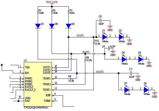

I would like to confirm the dimming ratio of TPS92630-Q1.
Could you please teach how much it is with PWM dimming?

Astsushi-san,
We can reach high dimming ratio using PWM dimming ratio by adding external circuit. What is your requirement on the dimming ratio? And what pwm frequency do you use, as it has big relationship on the dimming ratio.
Dear Anda-san,
Thank you for your response.
The customer needs PWM dimming ratio 5000:1. I don't know the PWM frequency and will confirm it.
If you can, could you please give the example for 5000:1? I will provide it to the customer.
And the thermal condition may be severe, because the condition is below;
- supply voltage: the battery (around 7 to 16V)
- LED VF: 3.3V (max 3.6V)
- LED current: 50mA/ch (3ch: 150mA)
Could you please teach other product for this condition if you can recommend?
