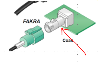

What type of connectors are on the DS90UB913A/914A EVM? In the DS90UB913A/914A EVM User's Manual, the connectors look to be SMB connectors, but since this is for an automotive application, shouldn't the connects be FAKRA?

    The 913A/914A EVMs will have 'male' FAKRA connectors as shown in the diagram below:
    The external EVM documentation is incorrect. It says SMB connectors, which is a FAKRA without enclosure. Unfortunately, the external EVM documentation was not updated accordingly.
