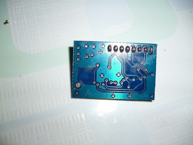

    I am building a car robot controler that use CC2500 and CC2591, but i have very short range tranceiver, it about 3 m.
    I think CC2591 not working, althought i connect PA_EN=1, EN=0 in TX mode, PA_EN=0, EN=1, HGM=0 in RX mode.
    Crystal is 26Mhz SMD C3225, MCU: msp430g2553.
    I need long range, about 300 m, someone help me?
    Thank you and best regard!
  • - Is this a 2 or 4 layer board
    - From the picture it looks like you don't have the maximum amount of vias under the RF chips, it should be at least 4 down to round from each chip.
    Apart from that I need schematic as pdf and layout as gerber to make further comments.

    This is 2 layer board, board type: FR4, via size: 1.0mm, diameter of drill is 0.6 mm.
    and this is schematic of my project:
    if via under chip pad not enought, i think the distant tranceiver  atleast 10 meter. But i only transmit data with 1 meter distant is maximum.
    I design look like this with cc1101, bank frequency is 433 Mhz, every thing so good, distant is about 70 meter.
    What's wrong with my schematic and layout?
    Thank you!
  • For a design using a FEM (as CC2591) it is highly recommended to use a 4 layer board. Good ground to the RF chips are important.
    I notice that your schematic is nowhere close to the recommended reference design I linked to in a earlier post in this thread.
