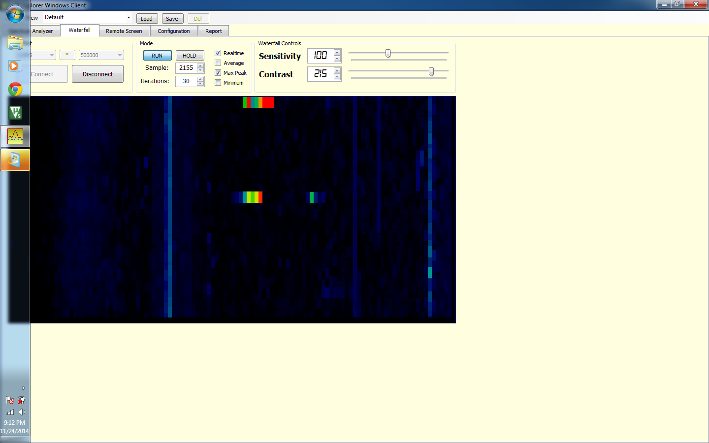

I'm trying to use the Smart RF studio to investigate why one of my custom boards is transmitting at 437 MHz instead of 433 MHz. Most of my other identical custom boards are quite well behaved and actually transmit at 433 MHz.
The Smart RF studio successfully detects the device. Unfortunately, the Smart RF studio crashes when I try to load the device control panel. The program crashes in Qt5Core.dll and I can share a crash dump if you folks give me a share. Workarounds are extremely welcome as well!

    Here's the waterfall diagram that I grabbed using an RFExplorer (the left edge is 425 MHz and the right edge is 445 MHz):
    Also, another weird observation, if I remove the antenna, I get a 433 signal with the same board. Also, when using a different antenna (one with higher gain), I actually hit a hang in one of the ReadSingleRegister functions because there is no DOUT interrupt, which may be related to http://e2e.ti.com/support/microcontrollers/msp430/f/166/t/178388.aspx. I mean, I guess I can understand why it is happening but it is strange that it happens only with a specific antenna :|
  • Is it only one CC430 connected to SmartRF Studio? I did some testing yesterday and Studio froze if anything else was connected.
    It should not be possible to change the frequency by removing the antenna. It seems like the VCO gets unstable. The plot you sent also indicate this since all energy should be at one frequency. Have you followed the ref design on your boards?

    Another data point, it seems that any of the boards can get into this state of transmitting at 437 MHz. A board that was transmitting at 433 MHz last week is now transmitting at 437 MHz. When it gets into this bad state, it just stays transmitting at 437 MHz regardless of the number of times I program the chip.
    If I change the FREQ2, FREQ1, FREQ0 registers, I do see the transmissions shift accordingly, which makes me think that the 437 MHz I see when I set FREQ to 433 MHz is some calibration issue. However, I set the device to auto-calibrate upon waking up from idle so I find it hard to believe that it is a calibration issue.
    Are there any other radio registers that I should be looking more closely at?

  • The chip contains 2 VCOs and dependent on the frequency either the "low" or "high" has to be selected. For some frequencies both will work but not equally good. In your case wrong settings could cause the wrong VCO to be selected and that this is not able to cover 433 MHz.
  • Ah, interesting. Where in the datasheet is this documented? Also, are you referring to "VCO_CORE_H_EN"?
    If not, how do I choose one VCO over another? How does the micro choose a VCO?
  • I recall changing the value of "VCO_CORE_H_EN" earlier today and didn't observe a difference. Do I need to set "VCO_SEL_CAL_EN" as well? Smart RF Studio doesn't set "VCO_SEL_CAL_EN" though....
  • Check that you use the recommended settings from SmartRF Studio, the selection of the VCO is done in a few registers, one of them is TEST0.
